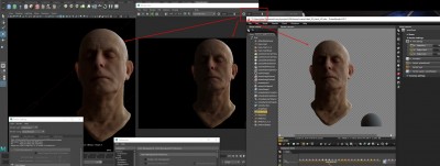

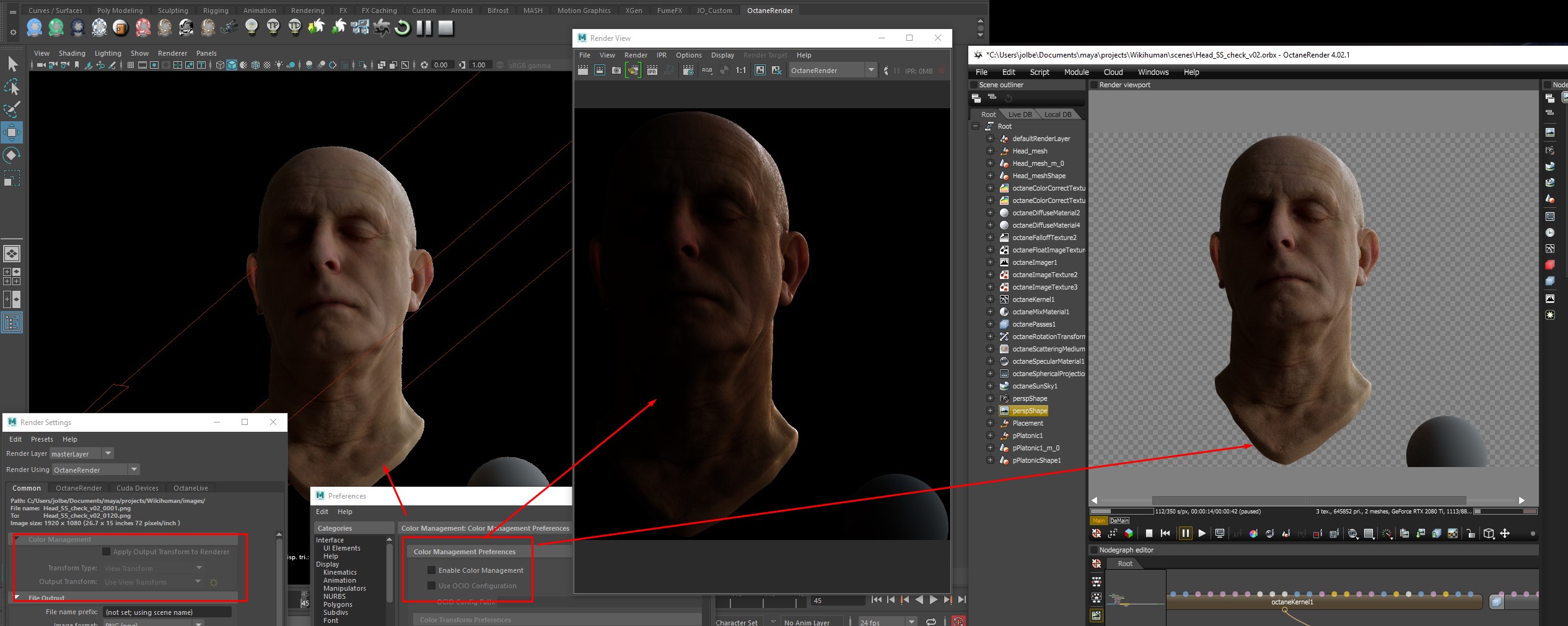

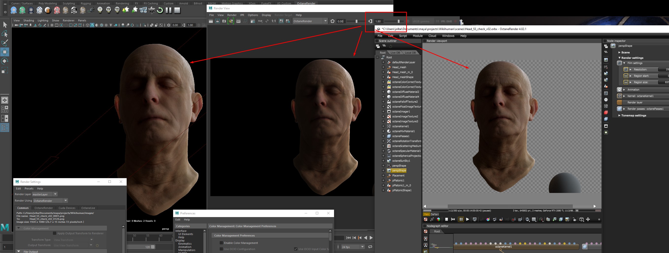

One other issue! with "Render View" and "View Port render" when I switch off color management the image from Render View has the wrong color space.
I checked with other version is fine. Please have a look at the screen shot

Be sure you have 8-bit selected in the output image settings if you want the 8-bit image in your renderView.Jolbertoquini wrote:Hi Jim,

JimStar wrote:Be sure you have 8-bit selected in the output image settings if you want the 8-bit image in your renderView.Jolbertoquini wrote:Hi Jim,
Hi Jim,
Unfortunately, have to disagree with that, cause color space is nothing to do with bit range at some instance, here is plug interpretation which doesn't respect standalone.
PNG 8bit and 16 Bit has the same color space "rgb"
and exr outputs has linear output but the exr with tonnemapping are saved with the colour space at "rgb"
I think was a miss interpretation the exr untonnemapped at 16 bit yes is "linear" but the png at 16bit is not linear is saved at srgb space from the standalone from Octane 2 already.
Please maybe update for the extension PNG .
Thanks,
JO

When you render in IPR it does not matter what image format you've selected PNG or EXR - only the bit depth and "tonemapped" settings matter. There is no "PNG" format in Maya viewport buffer, just direct image data from rendering engine.
So, if you need to play with 16/32-bit in your IPR session - just select the EXR and a needed bit depth and "tonemapped" setting (just because the PNG format section does not have the "tonemapped" setting you want to play with).
