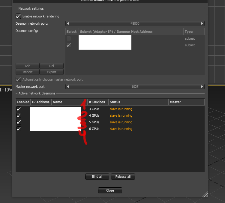

paride4331 wrote:Hi coilbook,coilbook wrote:Dear otoy,
after 3ds max is reopened I still get an error more than 20 gpus in use. I have to manually go to network and recheck all slaves for the message to disappear. There is still a slave network bug thinking I have more than 20 GPUs. I have exactly 20
could you check using SA, have you still this issue?
Regards
Paride
Hi Paride,
I cannot find error dialog in SA. Where is it?
So every time I open max I get this Started logging on 25.12.18 12:13:33
OctaneRender 4.00 RC7 (4000017)
the total count of GPUs used locally and over the network exceeds 20. ignoring slave xxxxxxxxx (7) with 5 device(s).
All gpus must be rechecked to work

coilbook wrote:paride4331 wrote:Hi coilbook,coilbook wrote:Dear otoy,
Regards
Paride
Hi Paride,
Hi Coilbook,
Windows > create Log window
Rgards
Paride
HI Paride,
SA does not have 20 gpu limit error. Only 3ds max plug in does it
Even disabling one video card in master and having only 19 it still turns off one of the slaves. So it is a network bug
When max is launched I have to uncheck all slaves. Then enable slave 4. Turn on octane viewport to check. Then 3,2,1 the same way. Or if I uncheck them all and recheck them it still might say "one slave is disabled due to gpu count"
- paride4331
- Posts: 3952
HI coilbook,
Thanks for your test, I sent this issue to 3dsMax developers.
Regards
Paride
Regards
Paride

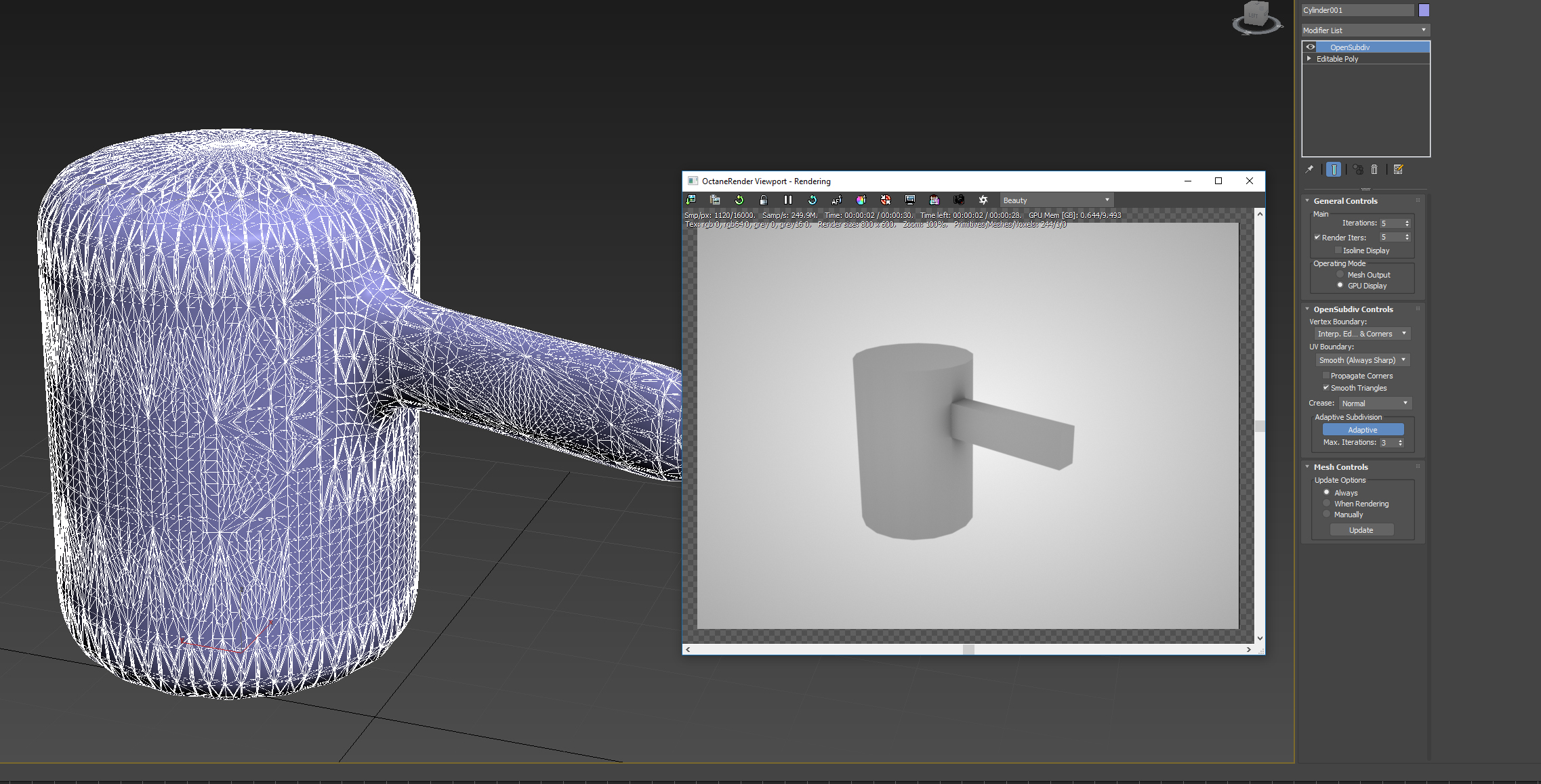

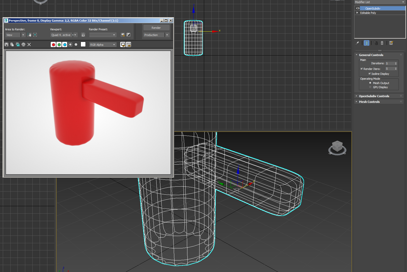

does octane support opensubdiv? It seems that it is not working right. When I set it to GU display or Render Iter to see the result during rendering nothing happens. It only works when dense mesh is displayed in a viewport
It seems that turbosmooth is not working either when smooth during rendering is checked. It used to work for sure in octane 3
I tried scanline renderer and it works great with render iters only or GPU display

Hi coilbook,coilbook wrote:does octane support opensubdiv? It seems that it is not working right. When I set it to GU display or Render Iter to see the result during rendering nothing happens. It only works when dense mesh is displayed in a viewport
it seems to work.
Regards
