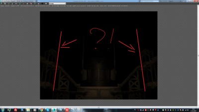

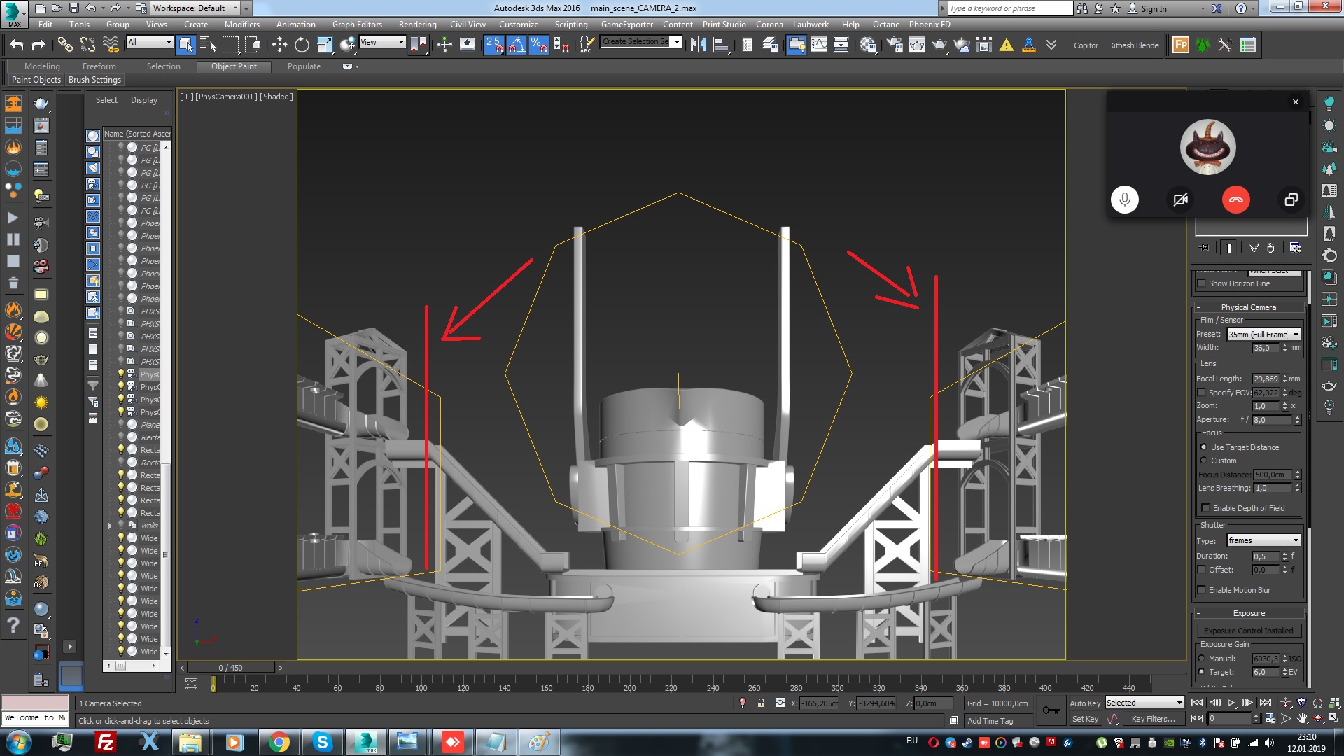

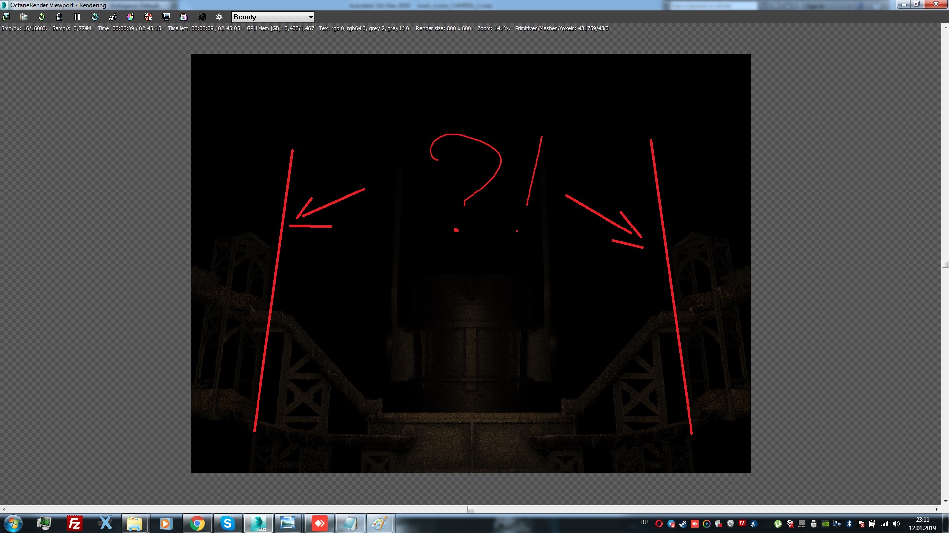

Why are the verticals not correct?
physical camera
win 7 /64x C2Quad 6600 2.4/ Nvidia 9800 GX2 1gb 512 bit + Asus 480 GTX/ DDR2 8Gb / NVIDIA 460 GTX 2GB/2x NVIDIA 580 GTX 3GB
