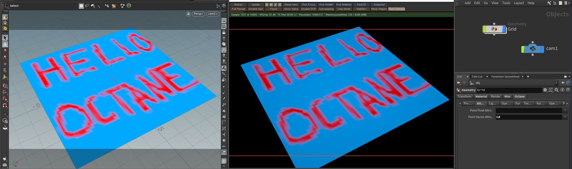

Any chances of a 2018.1 build. I’d love to try the new attributes stuff.
Just a polite request.
Regards
Rohan
Regards
Rohan

According to the picture you post few day ago, i"m kinda anxious.
It's really important to include float attributes, vector attributes and string attributes too.
It"s so helpful to be able to mess with strings to change texture path on shader level.
Is it just something you didn't think about yet, something harder to code or something impossible to do with Octane.
I pray for the first case. PLease, please, please !
It will be point only right ?
