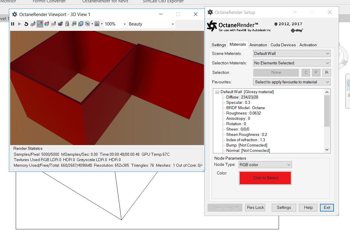

5, for this new build, the material for links issue is still not yet working, for example, if I change the color to red for material "default wall" in the 0.rvt, and in the 1.rvt I change the link mode for 0.rvt to "attach" (originally overlay so it will not apear in the main.rvt that is why at the begining ther is no need to erven provide it),then I got the below image:
the good thing is the wall from 0.rvt appears(as mentioned in item 4, which is not ignored and should not be), the bad thing is the color or say material is not consistance with it should be which is shown in revit native view

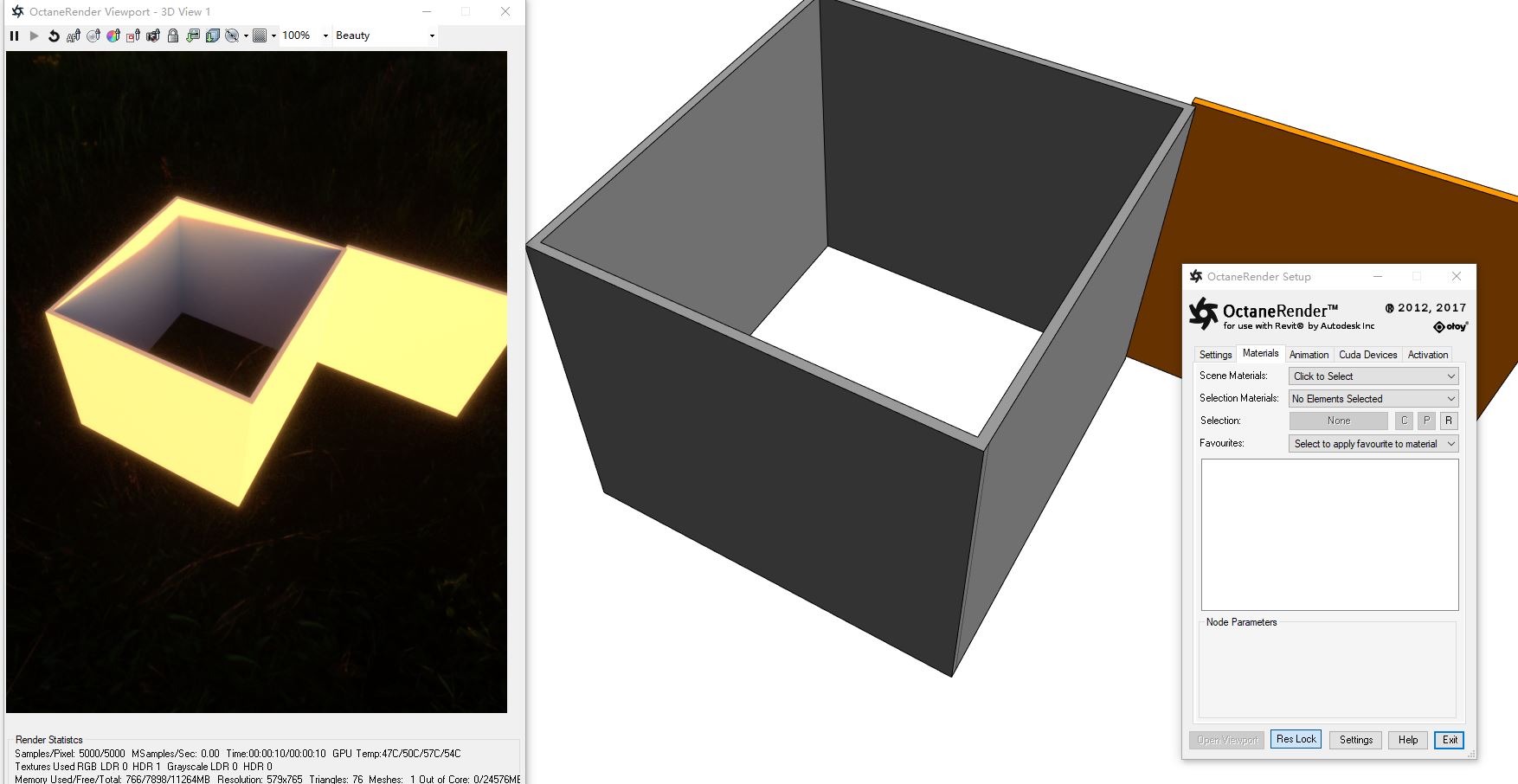

If you can download and unzip the latest rar file I uploaded at fFeb 2, you do not need to change anything, render it directly, you will get similar at the left image of the below attachment.
I said to change the wall to red does not mean to change the color in octane render's material in the main.rvt, I mean to change the revit material's color in the 0.rvt (base my previous uploads),in the latest upload this is already done, so you do not need to change the wall's color anymore...sorry for the confuse
so we are talking about different thing.
the right image at below is from the revit's shade display mode which shows the correct material color...

the situation is like:
1 in 0.rvt and main.rvt, there both a material named "default wall", but they are actually 2 different two materials and in 2 colors,
2,you may open 0.rvt separately and see the wall is in red color.
3, when open main.rvt, revit can show the two materials correctly, (in the shade mode, you may see the color)
4, octane plugin translate them into one material...

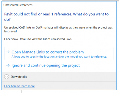

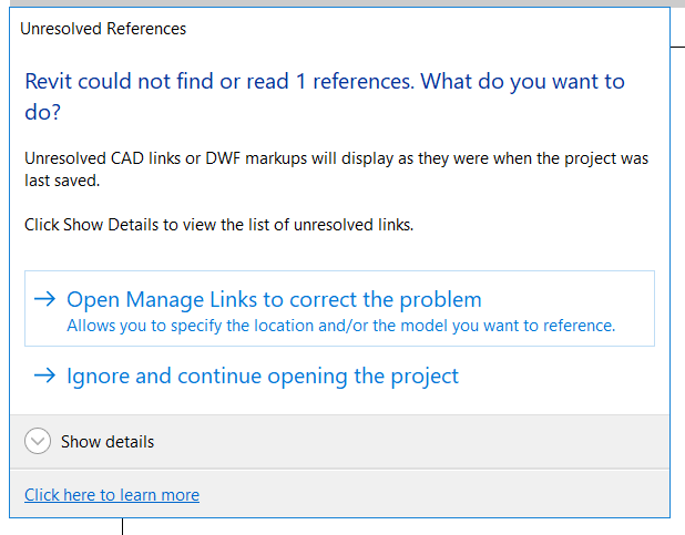

If I open main.rvt, I get

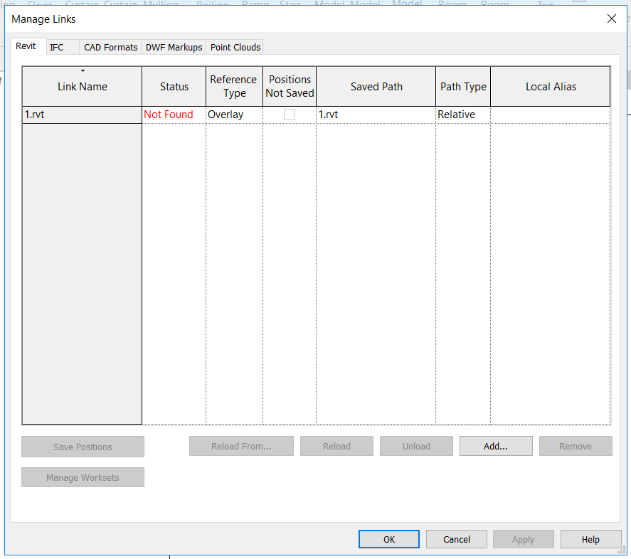

, and then resolving the links shows
and there is no 1.rvt in the zip you provided. So can you please confirm that you have uploaded the correct files.
