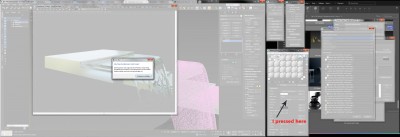

I updated Drives (with driver cleaner of course) to 417.22. But it happened sometimes in old version too.
It's just a random crash when I have viewport open and want to apply a texture to a slot. This time I pressed on roughness. The Materialbrowser opens and I get Instacrash.
The materialeditor opens with all submaps shown. I guess it is a 3dsmax issue but I don't have an idea how to prevent it. I closed the submaps thousand times but the setting doesn't get saved. So octane loads all sub-maps from my 3D-Scanned materials which are 4k and 8k in size. This could make Octane break. But I have no idea.
Now after reopening 3dsmax and doing the same steps it works. Like I said...random crash from time to time.
