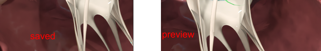

Slot 1 , Render Layer , OctdenoiserBeauty or Combined ( same result) .
Not right?

I do have another Blender file that FinalRender denoise seems to be working with.
Actually, I think it is working with the original file. I think that Blender is not displaying it as working.
When I save the image and look at in a paint program, it looks good.

Octane passes will be visible only after it finishes rendering. I don't know if it is Blender limitation but in Standalone it displays them during rendering.

I am letting the render finish. The denoising process is visible at the end of the render. Only 50 samples to make sure the denoising is obvious.
