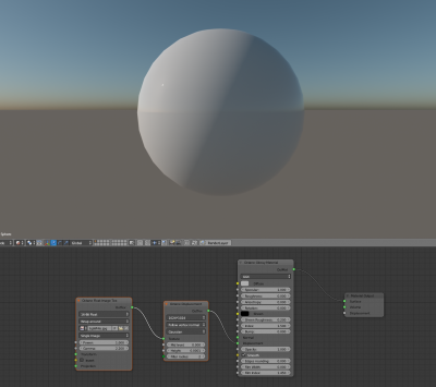

Anyone else discovered that the Octane nodes in Blender have less options as in the standalone version?

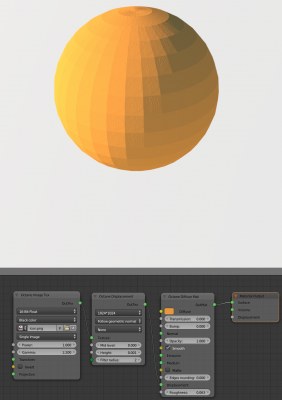

Hmm...don't see any difference....somehow the texture is mapped to each individual surface instead of the whole sphere...
UV mapping was always a nightmare for me with Octane in Blender (o;

Strange, It could be how you UV unwrapped it. I just did a spherical unwrap and didn't have any issues. I didn't even look at the results, which shouldn't matter.

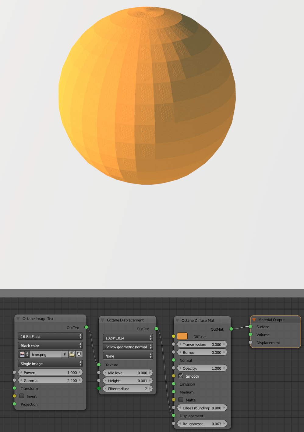

This works great and the memory usage is very minimal. This is just 128x128px one colour blank image.
