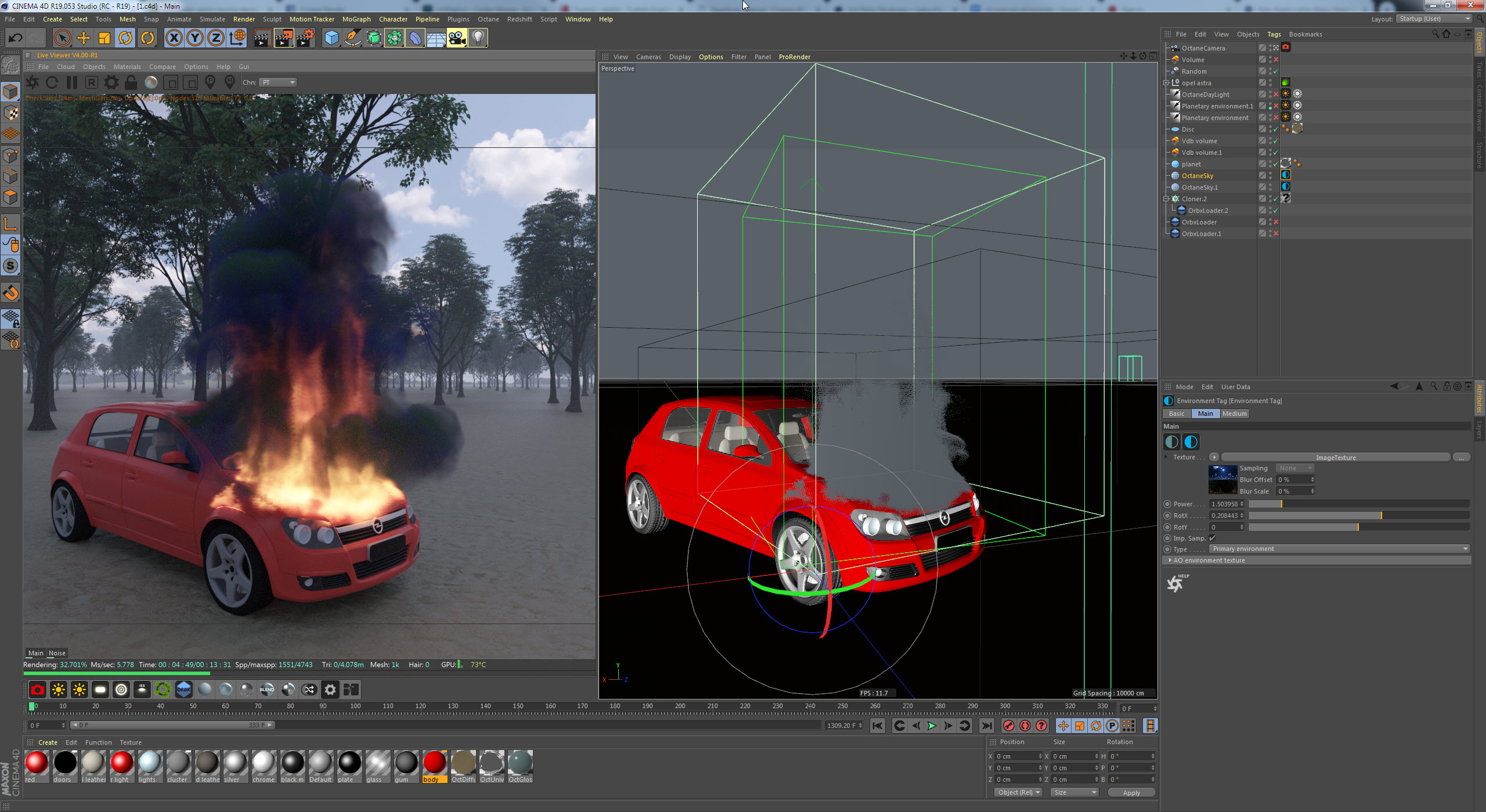

I'm on! Problem is unavailable channel names in vdb list.
Posts: 16068
Location: Türkiye
It's fixed I believe. The issue was the unrecognized channel names.

hey wrapthereal66,
do you have problems with long fumefx vdb animations? I could import the vdb from fumefx into either 3.08 or 4 without problems, but at my 400 frames animation (which looks good in 3ds max) it starts getting awkward after frame 168 or so - I cannot see it in the liveviewer anymore. If I scrub through the timeline after this, sometimes I get a glimpse of a frame, but it does not stay. If I render the animation, after 100 frames or so the renders start to be black, repeat from before and be very inconsistent.
It is the same with the aoktar version you got, too.
The size of the VDBs ranges from 20 to 170MB. Liveviewer stops working at around 85 MB.
I have to find out if my computer is the problem (updated gpu drivers, there is enough RAM, scene only 335 MB in GPU ram) or something else.
