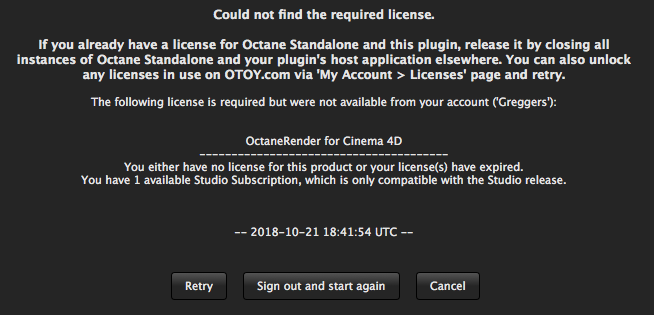

Its still not working. I have nothing to render. I just open cinema with the latest build 3.08.5 r2 studio edition and install in my plugins like usual. I Hit the live viewer and I get a pop up ( I attached a screenshot of the popup ).
I do have a regular octane standalone and regular modo plugin too, only cinema is the subscription version of octane I use. I have 3.08.5 and 3.08.4 standalone in my applications folder so I don't know if there is some sort of conflict. If I reinstall 3.08.4 of the cinema 4d plugin, it works fine.
Gregg

Hi Gregg,
from the error message, it seems that you have installed the regular commercial version of c4doctane, instead of the Studio subscription version.
ciao Beppe

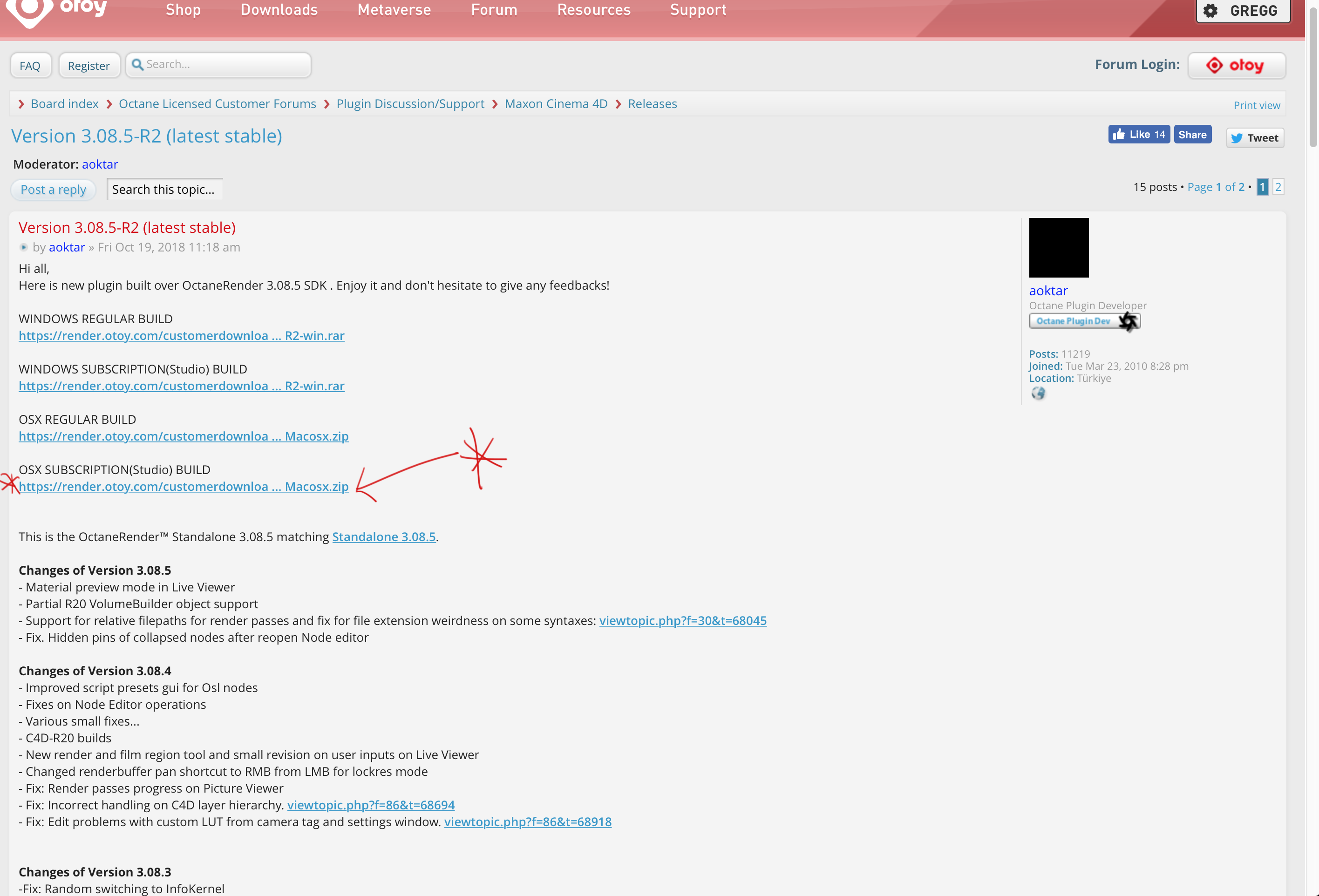

Hiya,
Im downloading the correct version. I have attached an image of which link I am using.
ps thank you for the reply

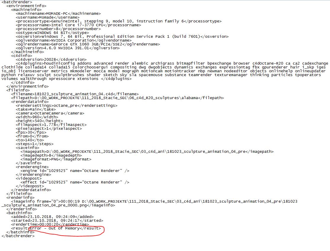

Aoktar. PM sent. Yet I discovered this in the .xml from render queue batch rendering:

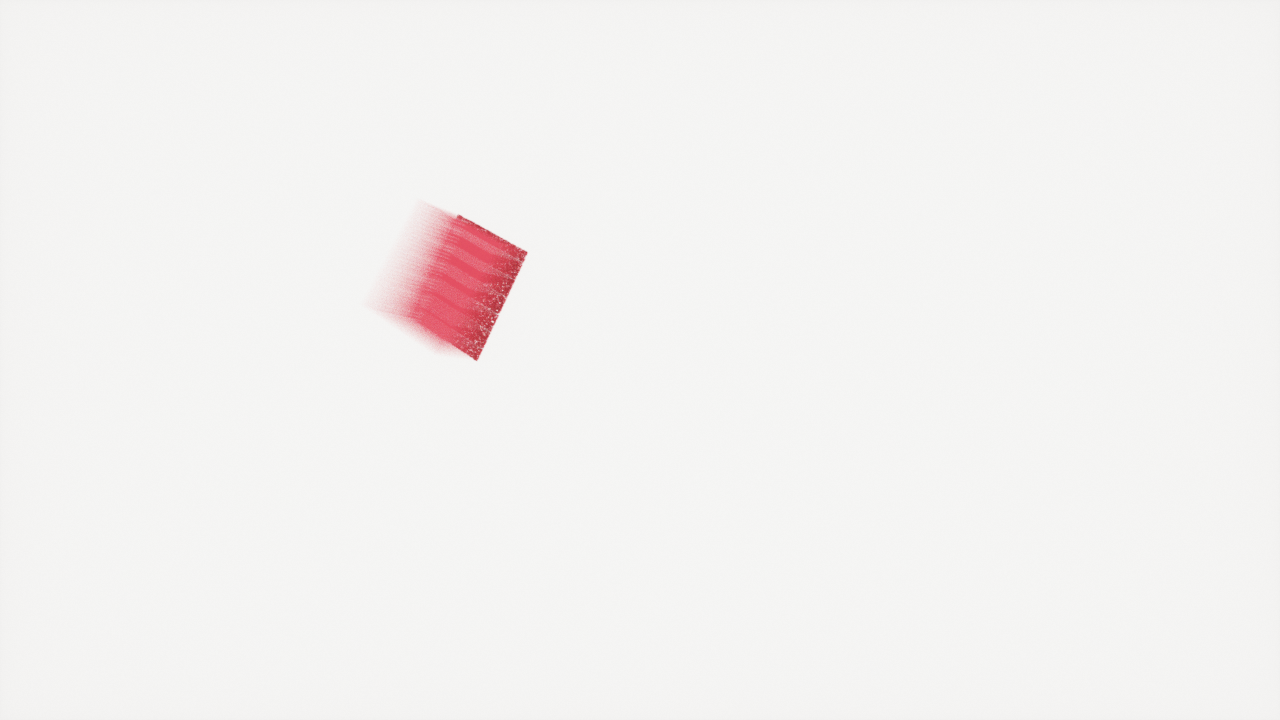

I dont seem to get motion blur produced on a very simple C4D hair object that generates hair on a plane geometry. In this attached example file the plane geo has motion blur, yet the hair is always sharp.
Waht am I doing wrong?
Need help quickly.

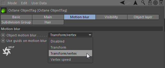

You need this
And manual
http://www.aoktar.com/octane/MotionBlur.html
