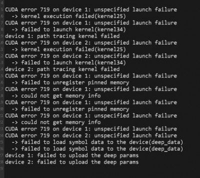

Hello,
i experience a lot of crashes (see octane log attached) when working on a med-complexity scene which use around 15 different octane materials. Somme of these materials are converted from substance-assets (perhaps the source of the problem ?). Octane (not c4d) crashes after 4-5 operations (material assign or light tweaking), so vry quickly ! impossible to work in these conditions...
The crashes happens both with 3.08.4 & 4 beta R5... I don't gather it is an hardware problem : with simplier scenes, all works very well... and i use redshift too, wich almost never crashes on such scenes. I've removed other plugins, but the crashes are still here...
Working on c4D R19.068, win1064, 3xGTX1070
i can send you the scene with assets, but in private mode, if it helps...
Please help !!...

V4 is not yet solid as 3.08.4. Did you applied the instructions from first page of this topic about crashes?vipvip wrote:Hello,
Please help !!...![]()
hello, & thanks for your quick answer.
no, i didn't read carefully these instructions. i will.
but as said on the previous reply, the bug happens very quickly with octane 3.08.4 too on this scene (the same scene, with materials done on v4)...

Yes send me by forum PM. But I think it's system specific issue, let's see...vipvip wrote:ican send to you a wetransfer link for the scene, if you're interested, please give me an email adress for this
