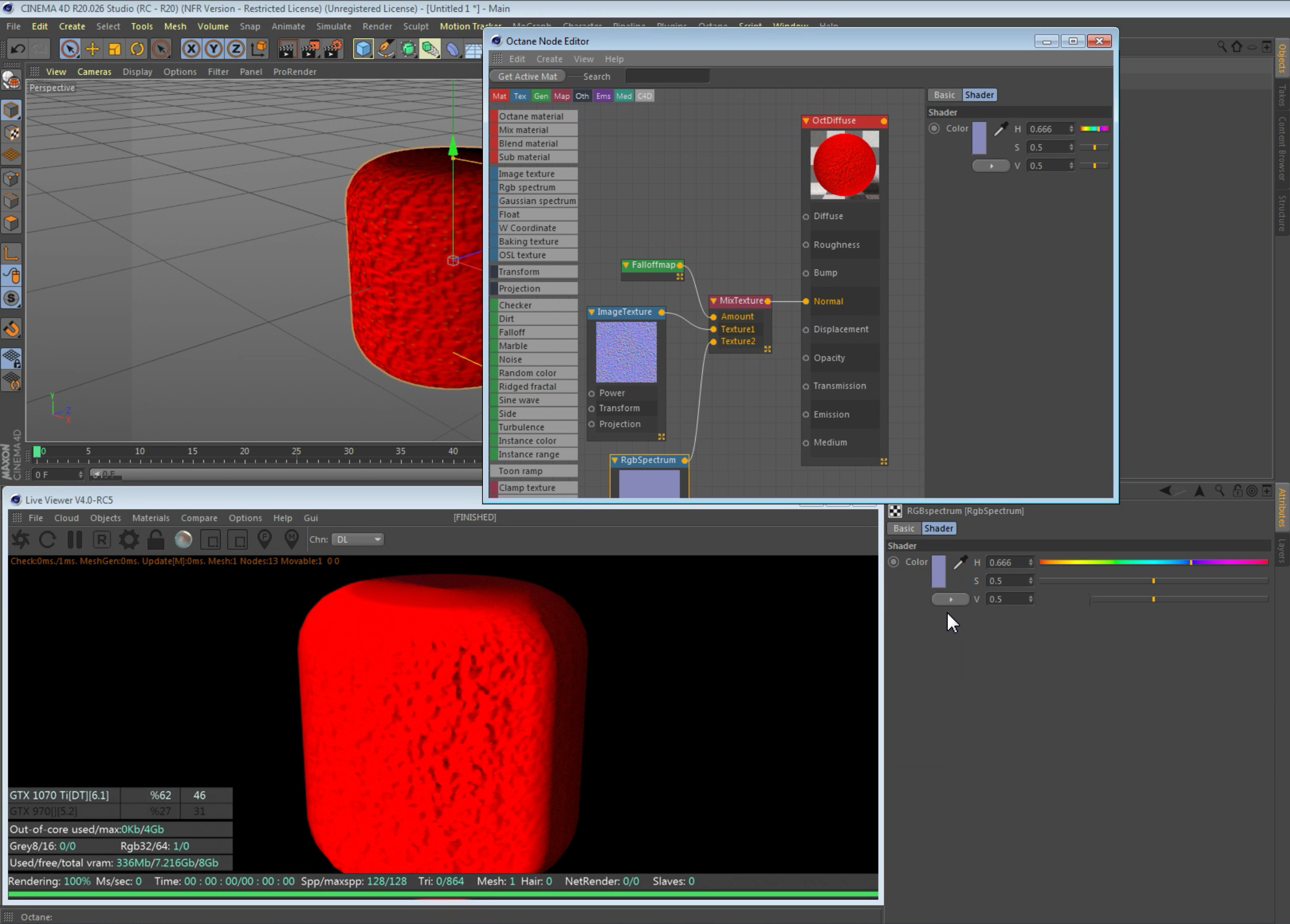

bepeg4d wrote:Here it is:
In HSV space:
H = 0.666
S = 0.5
V = 0.5
ciao Beppe
That's exactly the setup I had in mind but it didn't work with bump. Strange.

mitchino wrote:I want to do the same thing with a normal map i.e. use a fall off node to control the normal map so at direct angles there is a normal effect and at glancing angles there isn't. How would I set that up? If I do it the way I did it with bump where I used a 50% grey, what is the equivalent with a normal map?
You can do the same basic setup. There does seem to be a funny quirk where if you pipe an RGB color into the second Texture pin in the MixTex node, it can generate some odd Normal mapping artifacts. I've found it works just fine if you use a GaussianSpectrum node, though, and it doesn't seem to matter what the value of that GaussianSpectrum node is.
Here you can see the problem on the right. You'd think it would work fine with an RGB node set to 127,127,255, the Normal Map equivalent of 50% gray, but nope, that causes problems. Instead, just swap that RGB node with a Gaussian and it works.

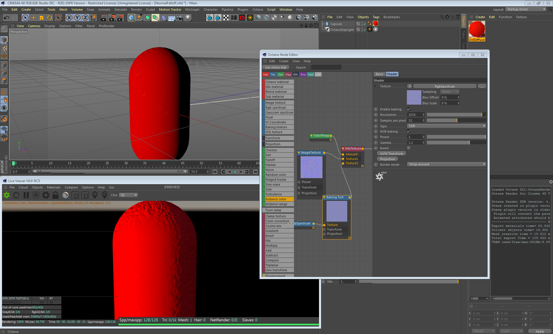

interesting find, in fact, if you pipe the RGB node into a Baking Texture, everything is working as expected:
ciao Beppe

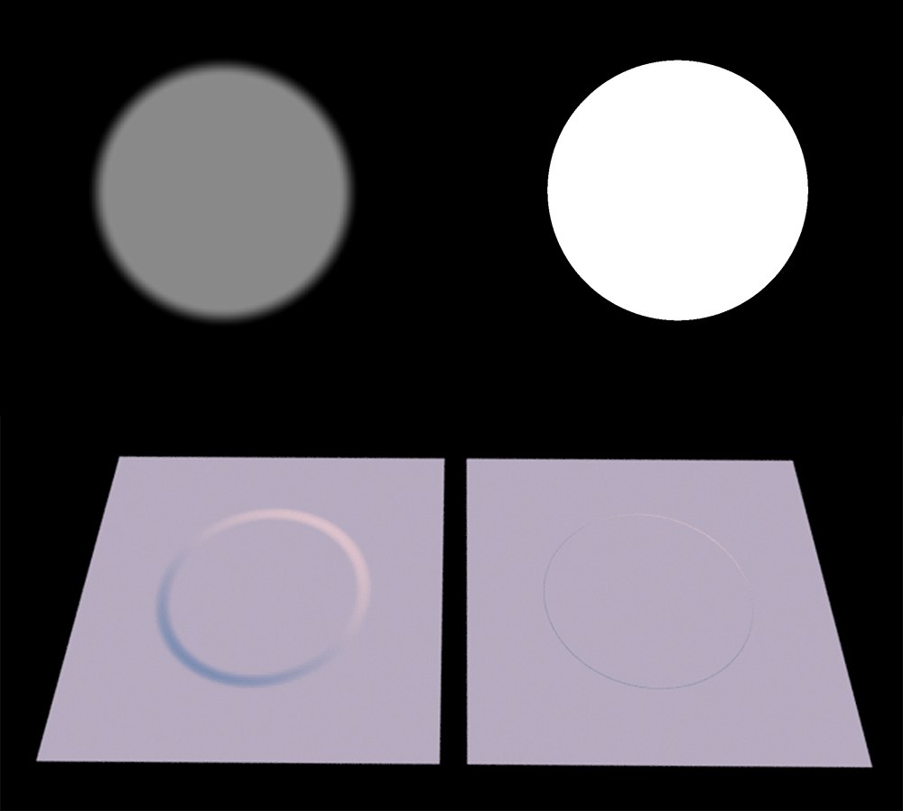

Regarding bump maps, there is also one more factor to consider -> resolution. Because bump maps, in general, are kind of a hack (emphasis on "in general" - please DO NOT go posting Octane bug reports based on this, I'm begging you) blurring a bump map can give you the appearance of stronger bump map. Adjusting the brightness of pixels might not work on something like text, for example. You should experiment with mixing a blurred and non blurred map too.
Texture on the right has higher resolution and, as a consequence of that, the edge of the circle is less blurred.
