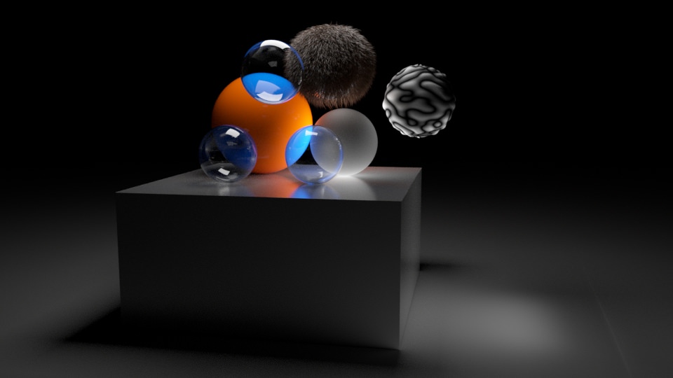

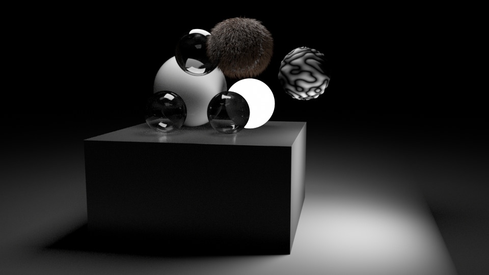

Here when I open the scene and OSL are ignored, the look is different.
Here with OSL the right lookup, after I just select the OSL script node and had a quick modification on the setting to read again. but after save and open the scene is look like previous image.

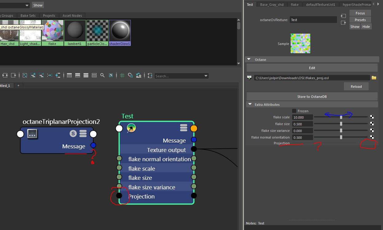

Other issue, Here is no way to connect the projection  node on osl cause the option or hided, the only way is a crasy hack to make work this need be better implemented also slider for number is jump crazy to on value bad slider. if I have unit set 1 so I slide a little bit I get 1000, million of unit, I know this is a mistake on script please fix like for the shader.
