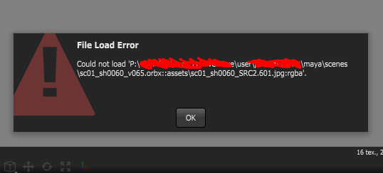

And another thing.
This version of plugin is too unstable, I can't render whole sequence because of crashes so tried to export ORBX and render my scene in standalone, and again - problem. Some textures that was linked in maya are lost after load ORBX into standalone.
To be honest - it's very far from STABLE. I would say it's still Alpha. Too many basic features are not working properly.
i7, 4x GTX 780, Maya.

Hi Vyoor,
We are unable to reproduce the error. Which version of Maya and the update are you running currently?
Is it possible to share the crash log file from the Temp folder, so we can investigate or the steps to replicate?
Cheers
Kind Regards
bk3d

Vyoor wrote:
And another thing.
Hi Vyoor,
Sorry, aparrently it's not a problem with orbx export but with kind of texture linking in maya. After opening this scene again the textures in some materials are also not working (octaneImageTexture nodes are connected to material),. It's happening when using animated textures and anim curve connected to "Image number" slot. Reloading and reconecting textures do nothing. To make it work i need to uncheck and check again "Use image sequence", but it's only temporary. When opening the scene it's lost again.
The crash log is in attachment.
I'm running maya 2017 Update 4.
Next update - there is not only Index and disperssion problem in specular material, now i have the same issue with octane glossy material and Roughness parameter...
When it could be fixed? I'm a little stuck with the project because of this :(

Posts: 1497
Hi Vyoor,
Thank you so much for the information and attaching the log file.
We have reported this issue to our developer.
Are you driving anim curve Set driven Key or any script? Could you please provide a sample scene or the steps to replicate?
It would be much faster for us to resolve.
We have confirmed the octane material parameters issue is related to Autodesk Maya 2017 API bug and the issue doesn't happen in 2018.4 !!
Also, please try to update Maya 2017 update 5 and see if the issue still happens.
We would try to get it fixed as soon as possible. I will keep you up to date.
