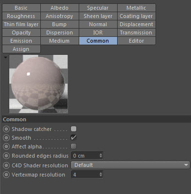

Studio21 wrote:@ahmet thx for the quick release! Fake shadows is missing in the universal material?
Thx,
Guy
It's here Guy!

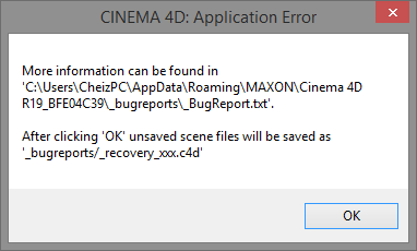

Not working here :(
It crashes when I start c4d. Worked wit previous XB4 build.

Yan wrote:Not working here :(
Version? Please send bug report?
C4d R19.068, WIndows 10
Bug report: https://www.dropbox.com/s/6eghevan78df0 ... t.txt?dl=0
