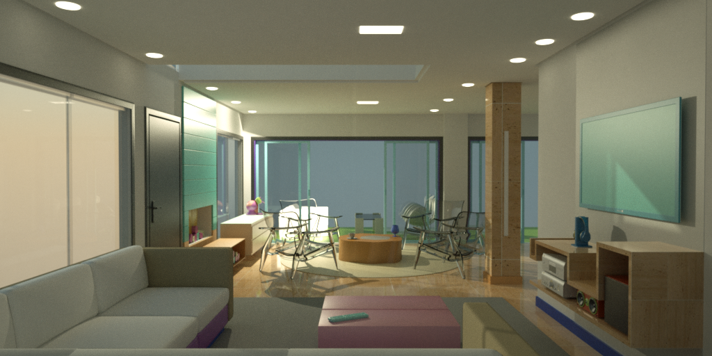

Nice job! Octane is able to deliver production render on interior scenes now. There was a indirect light, specular, glossy... on the scene I tested and it was great. Take some time to converge but it does! No fireflies. Thank you! I´m using 2x GTX 470 and it worked pretty fine on multi gpu mode. It is not linear but the gain is very good.
--> don´t know how to use those new controlers exploration_strength, direct light importance and maxrejects
--> I´m using CUDA 4.0
--> The render is a bit darker on pmc mode
