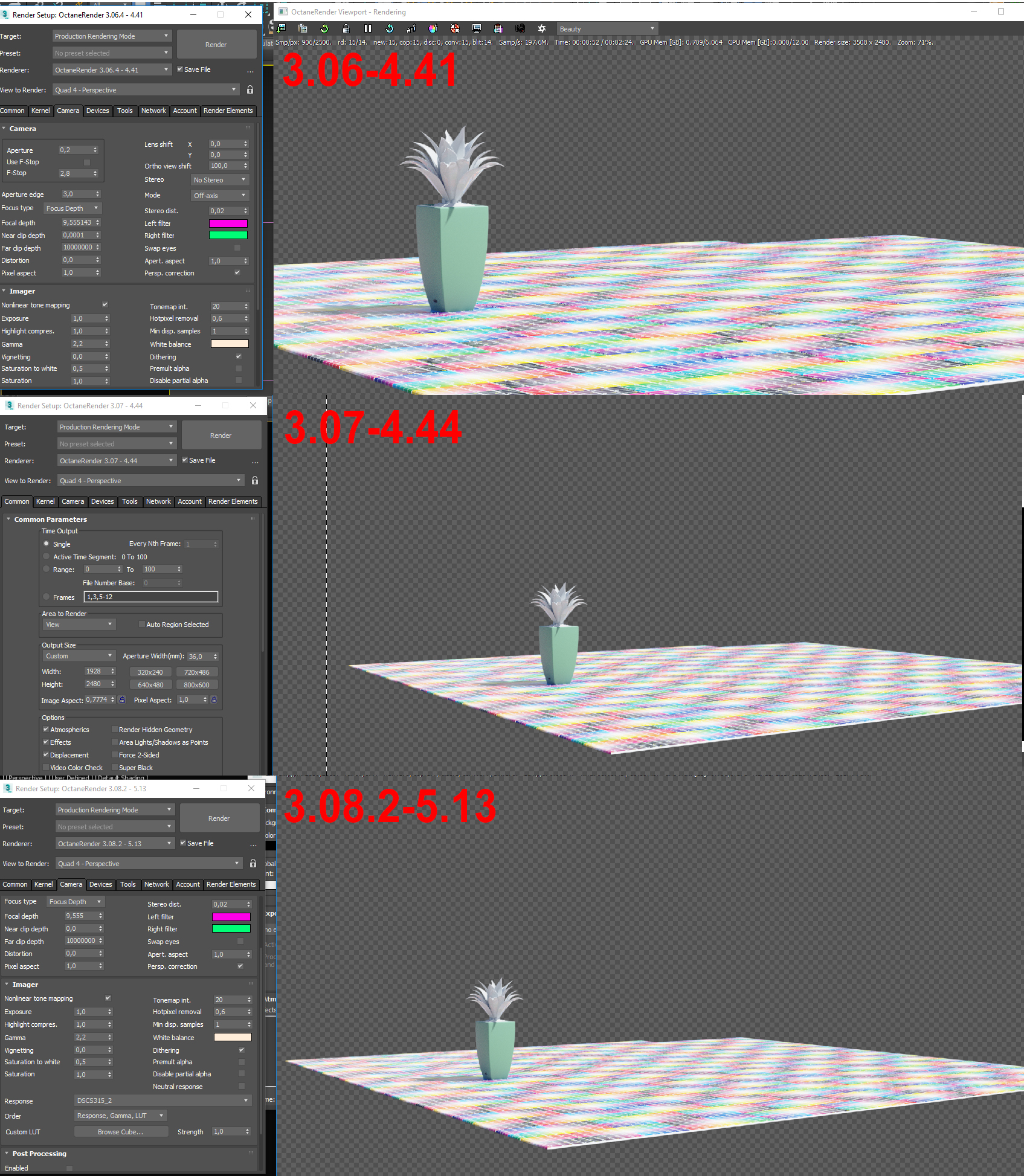

Hi mbetke,
I tested your scene using 3.06-4.41, 3.07-4.44, 3.08.02-5.13 everything seems to work.
I used my hdri; in your scene there was no camera, so I used your global camera imager setting.
I think your issue could depend on 3dsMAx gamma LUT setting.
what do you think about it?
Regards
Paride
Regards
Paride
