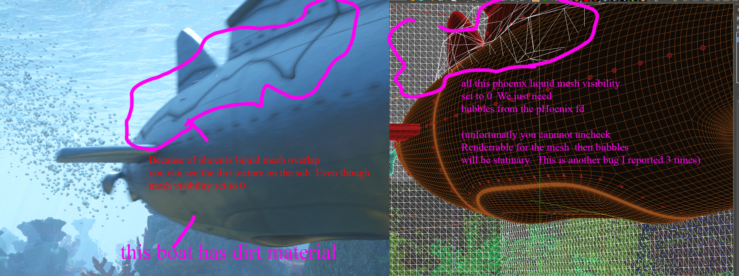

Since, I guess, we cannot have the dirt texture locked to one object (no influence by external mesh in close proximity) Can we at least have objects that are set to invisible not to generate dirt on objects with dirt material or please make it where dirt is locked to one mesh only Please!!!!!!!!!

Baking dirt to a texture could speedup your renders DRAMATICALLY. Just make a separate scene with the boat isolated and a white diffuse material with dirt, switch the camera to bake and use that render instead of dirt on your model. If the model doesn't have UVs even a basic 5 minute unwrap will do. If you change your mind about the radius, later you can just open up that scene and update the map. I'm saying all this because I had an unpleasant experience on a model with over 6000 elements where Dirt caused a MASSIVE slowdown and it actually makes perfect sense because it's a shader that has to go back and raytrace other pieces of geometry for every pixel in your final render. Same approach is needed for rounded edges and is probably very very hard to make changes to Dirt or introduce features like that without causing a major slow down in Octane.
With all of that said, why the hell are you not complaining to Phoenix FD !!!!???
