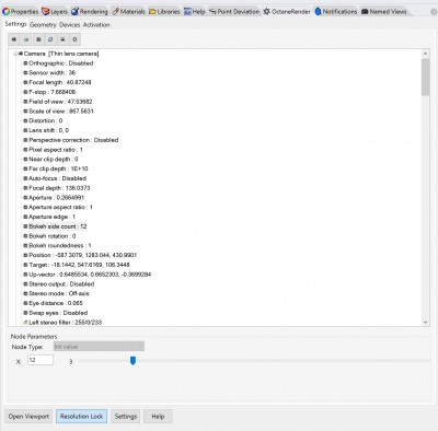

unreadable Cctane tab
Moderator: face_off
face_off
Posts: 15830
Location: Adelaide, Australia
looks good now.
It looks like the right hand side of the slider is off the screen. If you expand the tab width, does it come into view?
Paul
rpict
Posts: 17
Joined: Sat May 15, 2010 4:55 pm
no :(
-rpict
Win 10 64 | GTX 1060 | i7-7700HQ 2.80GHz | 32GB | 4k
face_off
Posts: 15830
And can you provide a screenshot of your Windows->Settings->System->Display->Advanced Scale Settings and font scaling settings pls.

I have updated the current TEST build for Rhino6 to further fix UI scaling issues (release number has not changed - still 3.08.1.92). Sliders should no longer be disappearing off to the right of the panel, and the RGB color node should no longer have the button misplaced. Can users pls confirm that all UI issues for Rhino6 are now fixed for them, and I will do a full release.
