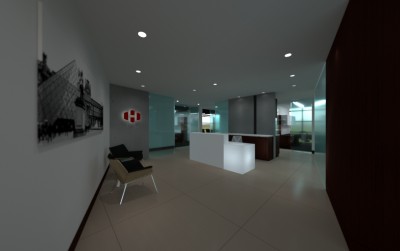

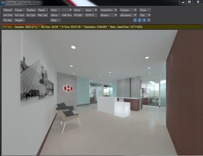

Anyone else notice darker renders coming out of 3.08.1.0? It's seems to be a gamma issue, but not quite. I haven't changed any of my RenderTarget settings either. I didn't use the 3.08.0 production build (went straight to 3.08.1.0) so don't know if it was an issue there. IPR works fine, but have noticed when I use the Save JPG/EXR feature, the images are darker when saved (same gamma issue?). Still on 2015.3, Octane 3.08.1.0.

Yes, it seems some kind of gamma or tonemapping issue. If you have all the LW color correction options disabled this should not happen. If you have a scene to reproduce this problem, I can take a look at it here.

EDIT: UGH! Sneaky little bugger that LW. I was looking through the Color Settings in LW (like you suggested) and I must've loaded the Newtek default scene instead of the default scene that I regularly use and it had shifted all the color settings back to sRGB.

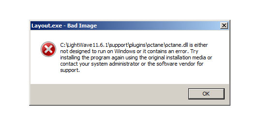

Hi, getting this error when installing on Win 7, LW 11.6.1
I have installed the redistributable.

gristle wrote:Hi, getting this error when installing on Win 7, LW 11.6.1
Have you installed the Visual C++ 2015 redistributable? Now the plugin is working with it, not with the old 2012 version:
https://www.microsoft.com/en-US/downloa ... x?id=53587
In any case, do you know if the Standalone 3.08.1 works fine on this system? You can find the link to download it on this same topic.

Yes, I went to install the 2015 redistributable and it was already installed.
I can try again, will try stand alone first though.

The standalone full version and demo 3.08 will not run, 'Windows cannot verify the digital signature for this file'.
I had the 2017 C++ redistributable installed
I give up for now, got some rendering to do!

gristle wrote:The standalone full version and demo 3.08 will not run, 'Windows cannot verify the digital signature for this file'.
Cheers
Please, take a look at this post:
viewtopic.php?f=25&t=66073

Thanks a million Juanjo!
