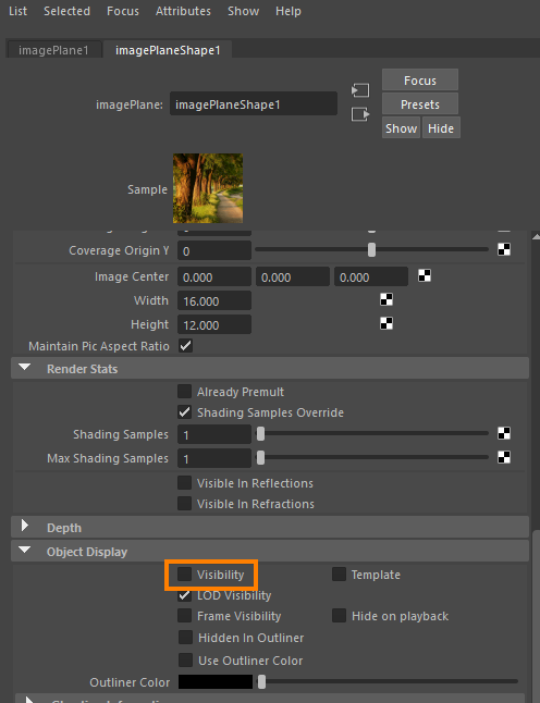

nedan wrote:I totally agree about image planes. They appear even hidden or on different render layers.
Hi Nedan,
Thank you so much. Please try using the Visibilty checkbox from the Object Display rollout in shape node to chose whether to render the BG or not.
2018-04-18 11_41_36-Autodesk Maya 2018 - Not for Resale_ A__WS_BK_Files_My Documents_BUG_Maya_bug_20.png
Maya render layers is currently yet to support form Maya Image Plane.
Kind Regards

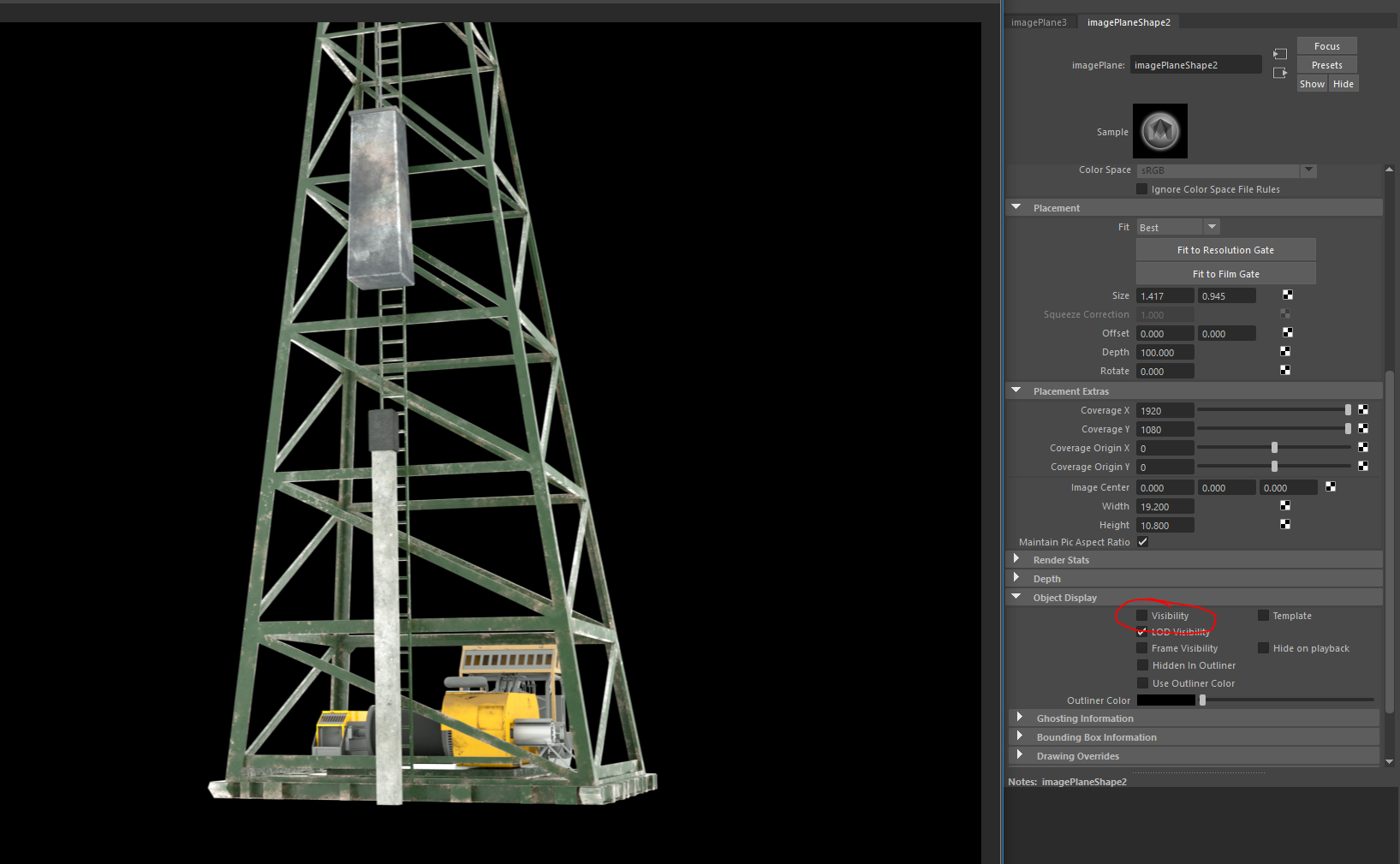

zurakan
Posts: 44
Joined: Fri Sep 27, 2013 7:13 am
Thank mr.BK
It work
confirm this option Visibilty checkbox can turn off when rendering
Hi Nedan,
The attachment 2018-04-18 11_41_36-Autodesk Maya 2018 - Not for Resale_ A__WS_BK_Files_My Documents_BUG_Maya_bug_20.png is no longer available
