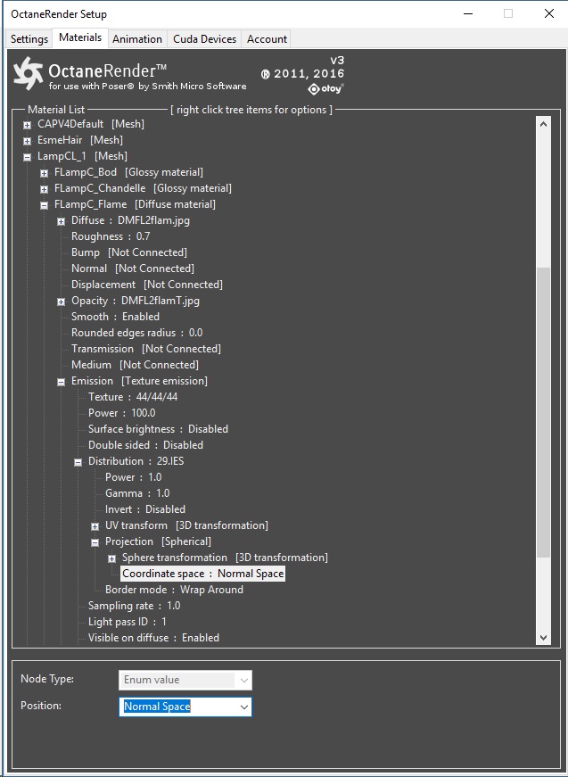

By default lights, are emitted in all directions from each normal (so 180 degrees). You can control this by using IES distribution maps. An IES map is an industry wide standard (with CG and in the real world) to defiine how lights behave. See a tutorial on this here: http://www.cgarena.com/freestuff/tutori ... ieslights/
Load an IES map (RGB texture node) in the distribution node. Set the gamma to 1. Now expand the projection node for the texture and set the coordinate space to Normal Space. (This is REALLY important otherwise it will not work)
That is it.
That tutorial link tells you have to look at the maps and how to create them. In this link https://support.solidangle.com/display/ ... tric+Light there is a link with a set of very nice IES lights. Download the sample picture of it as well, it is handy to have to know what each of the IES maps do. Number 29 for instance is a nice spotlight with defined soft edges.

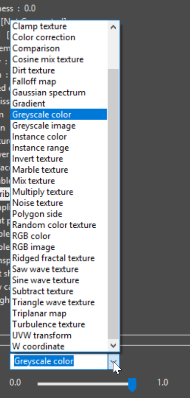

wow. now that' a big lesson :) I've never used IES. Reading the tutotial, thanks! which option should I pick in order to use an IES map? RGB image?

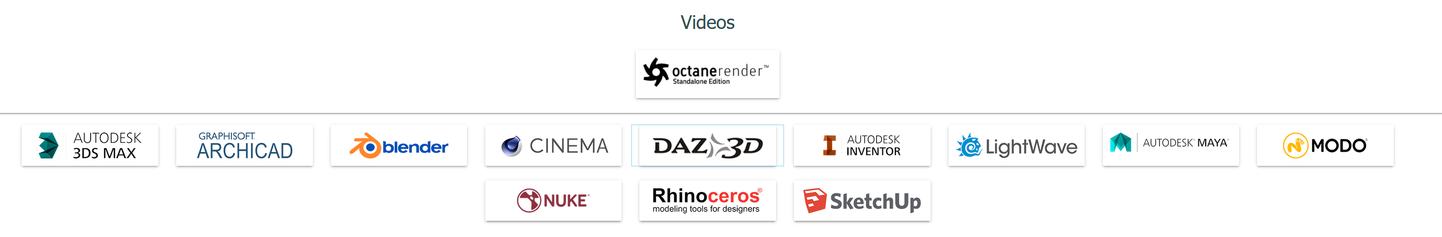

there seems to be no videos for poser in the videos tab:

I lot of the questions you are asking are generic Octane questions - so the Octane Standalone videos will help you.

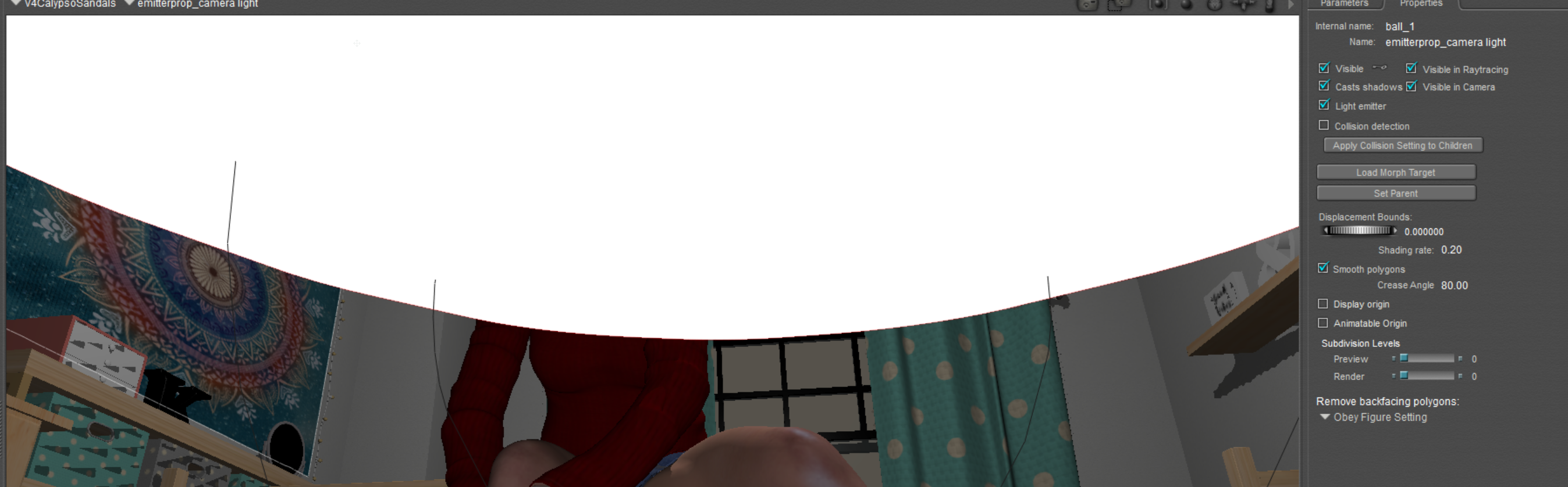

I'v bumped into another issue with Emitters: I've noticed that if i choose to set the emitter as invisible (within my poser preview scene) - it will also won't show up in the octane Render. that's a bit of a problem, since I tend to also create camera lights (A light that is parented to a camera), and than the Emitter prop gets in the middle of the vision in preview, so I have to turn visibility off, work on my scene, than set it back to visible when I open the viewport. setting the opacity within OR won't help. is there a way around this? (setting emitters to be invisible in poser but still cast lights when I open the viewport and render, just like poser lights behave?)

Move the one sided plane behind the camera
