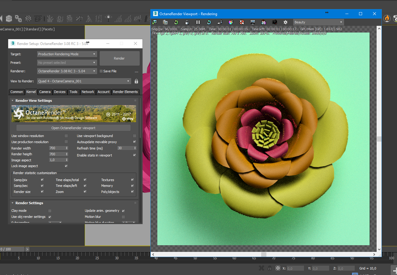

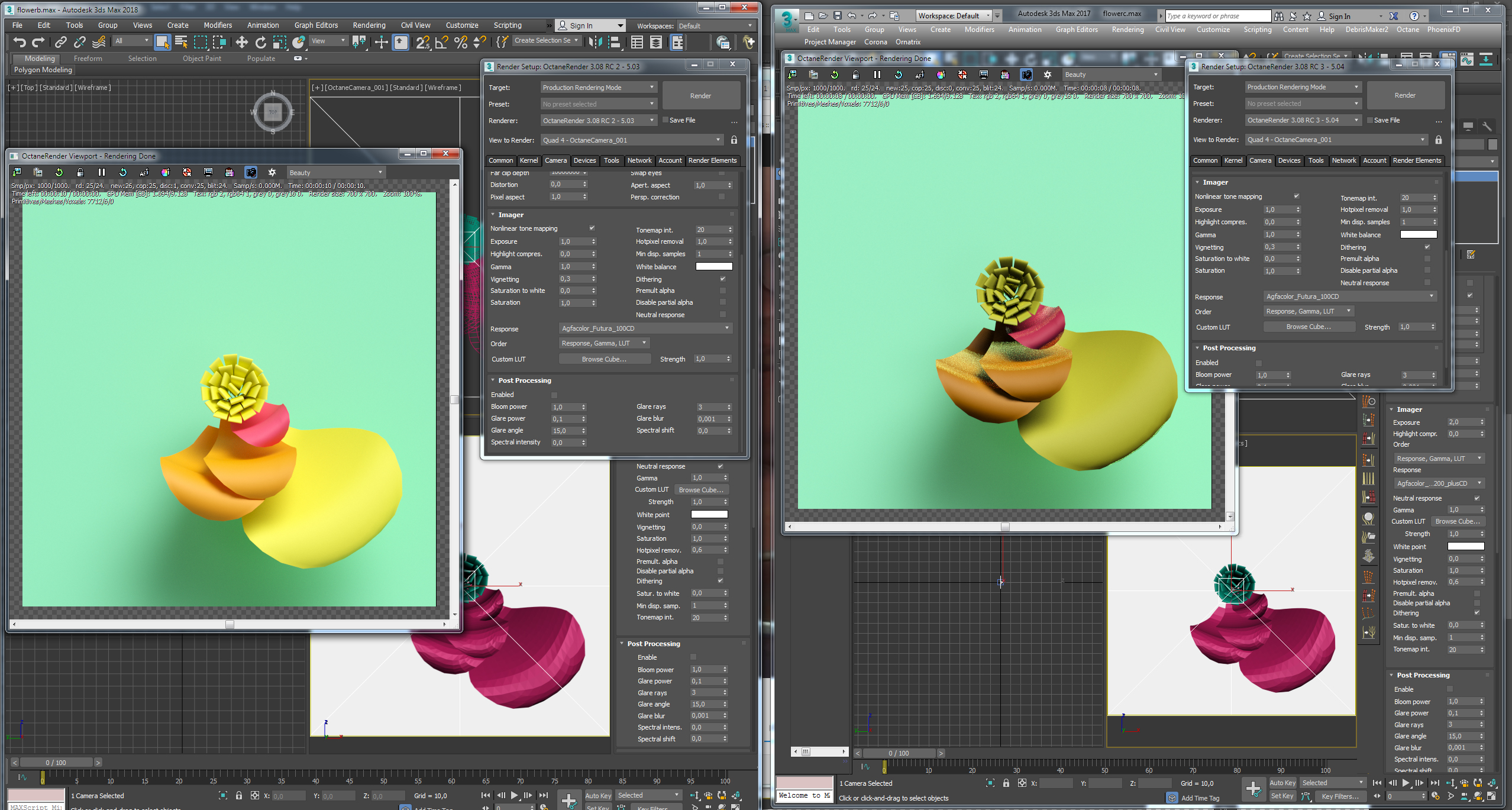

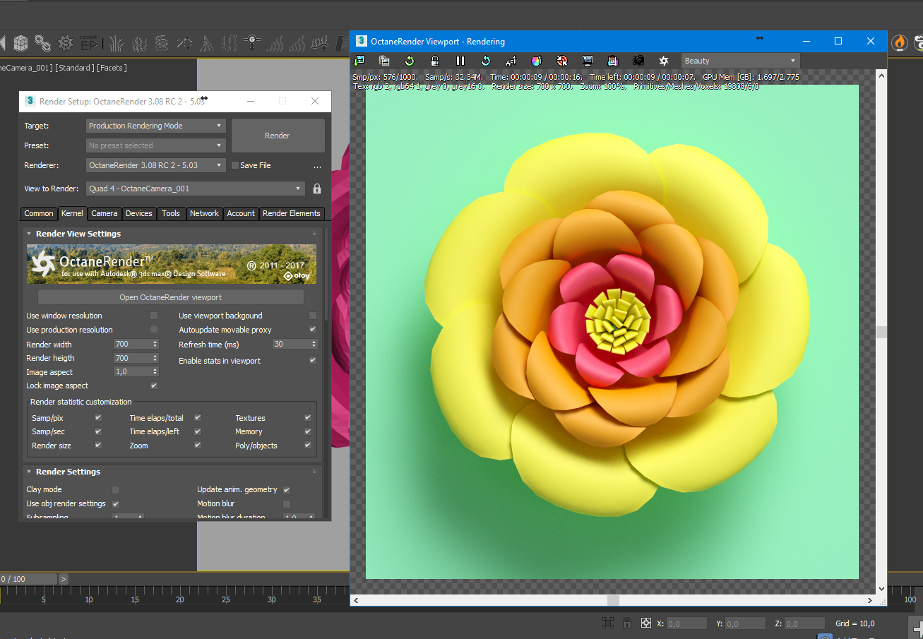

Something is broken.
1) v3.08 RC3 - 5.03 - OK
2) v3.08 RC3 - 5.04 - light and colors wrong, render has some artifacts.
3) export from v3.08 RC3 5.04 -> to standalone (v4) - image is OK
Scene file: https://www.dropbox.com/s/mbxqwdiksqm60 ... r.max?dl=0

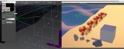

I am trying to scatter clouds as instances but with different scattering intensity. When I change scattering color to gradient texture with random color texture clouds turn red. Any way have clouds of different scattering values? Would be nice if density could have texture slot to have instance clouds of different density. Thank you

ramone163 wrote:Something is broken.
Hi ramone163,
I can't test your scene, make a 3dsMax archive file please.
Regards
Paride

Hi Ramones163,
thanks, I tested your file, yes sometimes doesn't work well, but this issue seems to happen only with your file, I tested 5.03 and 5.04 with another file and everything seems ok.
Did you try with other scenes?
Regards
Paride

Hi Can someone help me with gradient texture and scatter Why is it red? Thanks
Rik
Posts: 423
Joined: Wed Jul 28, 2010 8:57 pm
What colour is the third pointer/triangle on your gradient bar?
The one at the right hand end looks white but if you select it you may find it's actually red?
