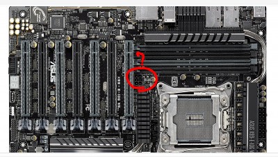

Hi i just built a salve system with asus X99-E-10G WS it has 3 video cards with netstor turbox attached total 7. When I send over a scene to render I get PC just rebooting with the crash or just completely freezing. is this basically the same problem you are having? I do have window 10 and I am afraid windows 7 wont even recognize 7 GPus Not sure what to do :(
There is also 6 pin connector that I never connected. Not sure what it is for. My evga 1600 does not even have this kind of cable.
i tried 382. drivers and i cannot even use them with because octane 3.08 says cuda driver version is too low.
itou31
Posts: 377
Joined: Tue Jan 22, 2013 8:43 am
This connector helps power for PCIe, I think that you should connect it to the power supply. Be carefull, chek the polarity. On my board, I've connected all power connector (Xeon overclocking and 7 GPUs)
