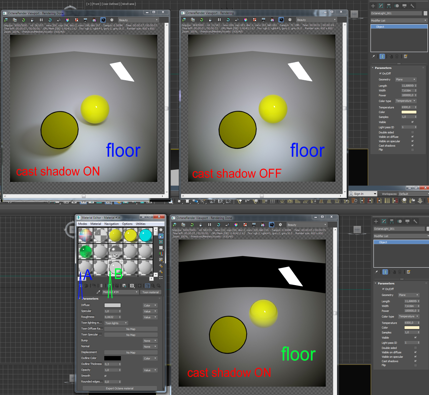

Hi Rico_Uk,Rico_uk wrote:Hi Paride. Yes indeed, what I was meaning is that an Octane light will cause a Toon light to cast shadows. I've attached a still to help to explain.
Cast shadow option does not work with toon material; as you can see using diffuse material (A) cast shadow works fine, but not using toon material (B).
Regards
Paride
What I'm trying to do is have toon materials and toon lights in the same scene as octane materials and octane lights, and I don't want the octane lights to cast shadows onto the toon material (as shown in the image in my last post where the rectangular shadow from the octane light can be seen on the surface of the toon material object).
- paride4331
- Posts: 3972
Hi Rico_uK,Rico_uk wrote:What I'm trying to do is have toon materials and toon lights in the same scene as octane materials and octane lights, and I don't want the octane lights to cast shadows onto the toon material (as shown in the image in my last post where the rectangular shadow from the octane light can be seen on the surface of the toon material object).
I advise you to use geometry with emission texture node, set opacity 0.
Regards
Paride
