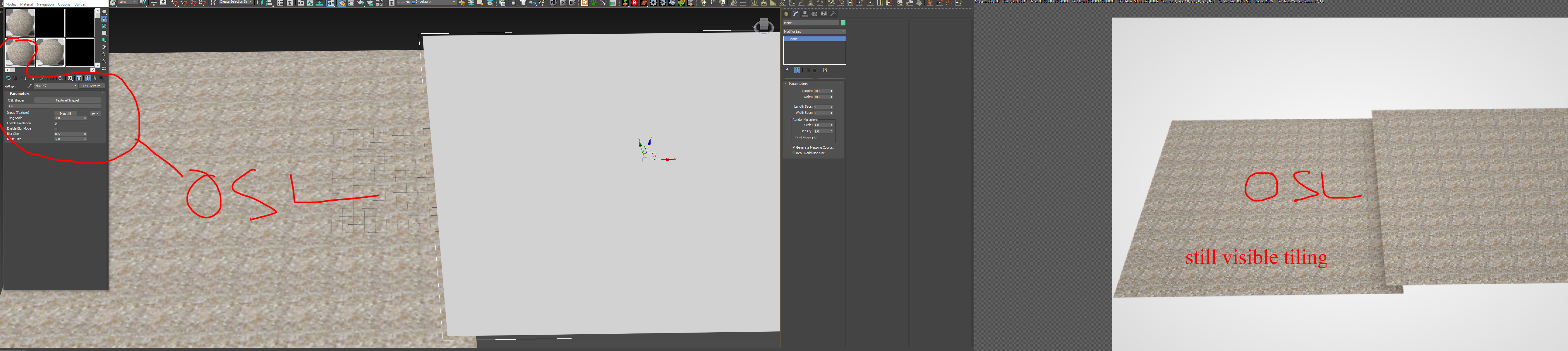

I change scale to 0.1 from 0.3 of the actual texture to get smaller stones but tiling is still visible with OSL Am i doing anything wrong? Thanks
paride4331
Posts: 4004
Hi coilbook,
OSL tiling texture works with tiling and noise, its effect depends on the size of the surface where you apply it too.
Regards

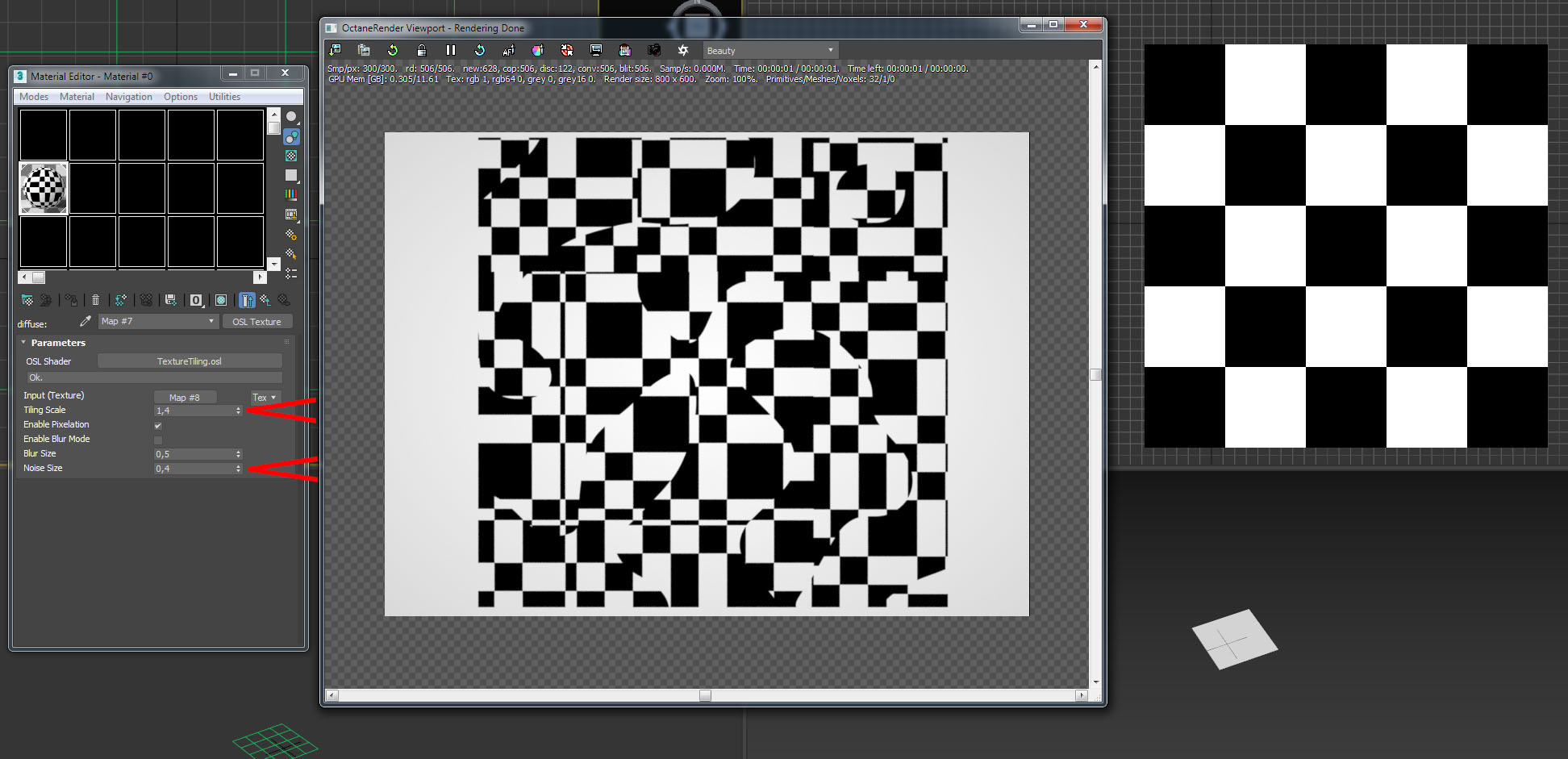

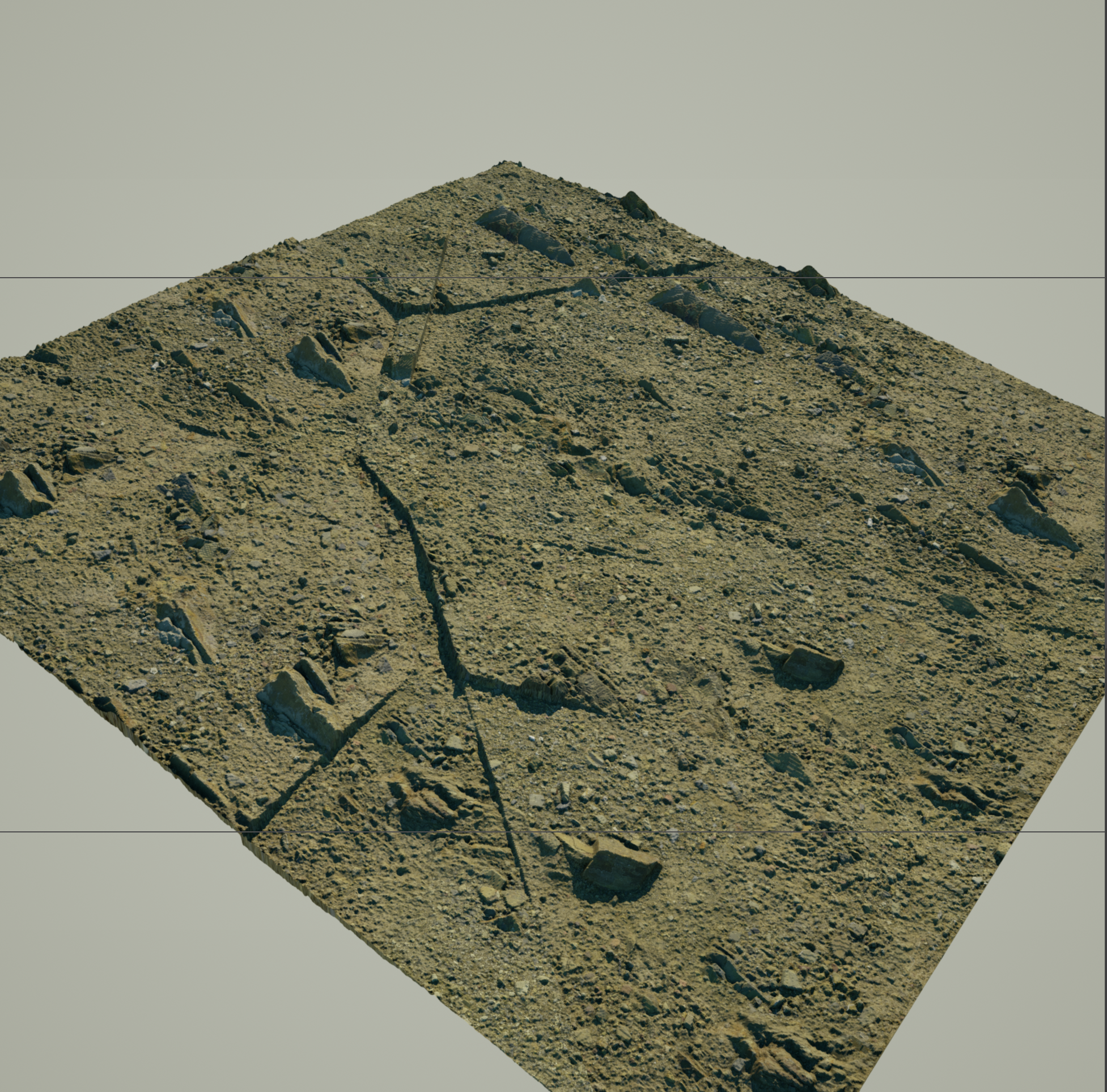

I get big cracks and i don't know how to fix them?
Any ideas?
paride4331
Posts: 4004
I guess you should increase the geometry subdivision.
