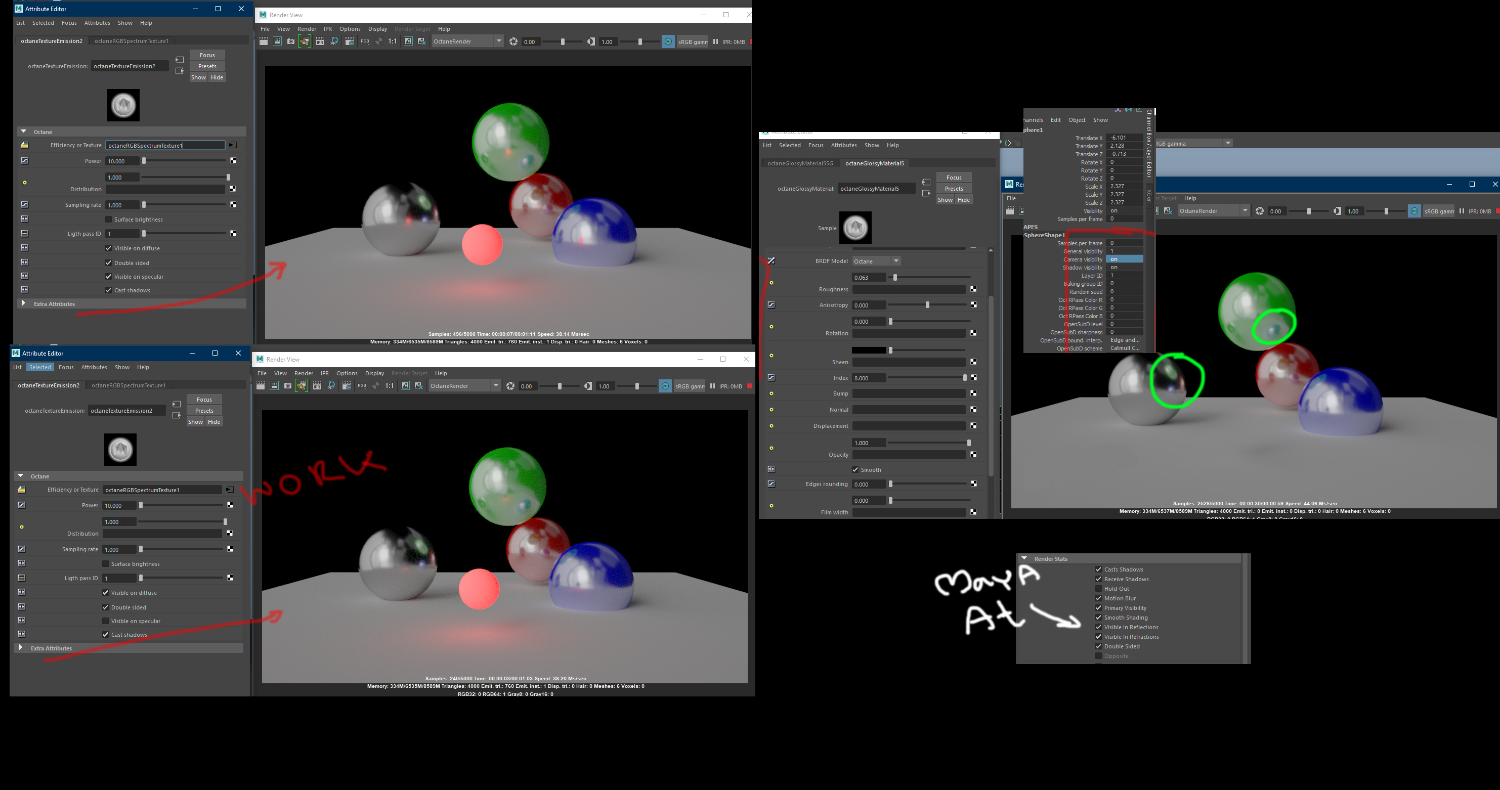

hello R/D team today just test some option in New version

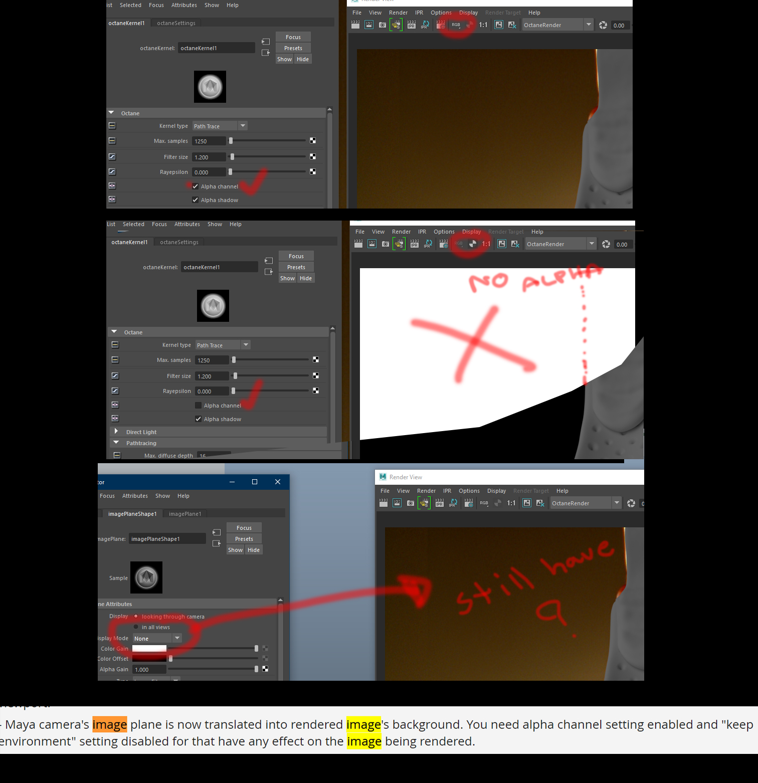

1 ) How it work image Plane ? last version i have to delete image plane node before i hit render
2).Can you make option visible in Reflections and Visible in Refraction on Object Or shader ?
thank so much

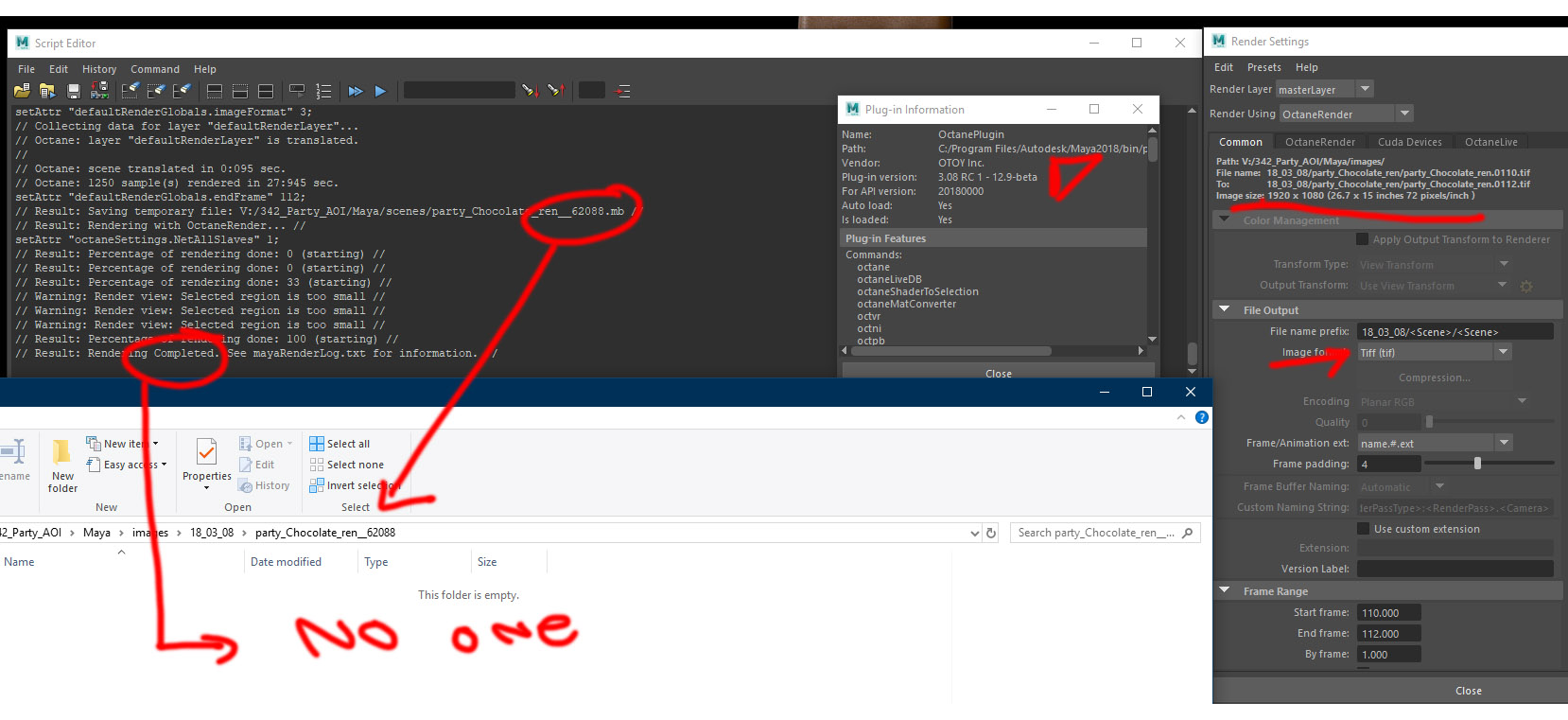

hello again I found the Big issue , I Can't find batch render output deadline render Can't find too

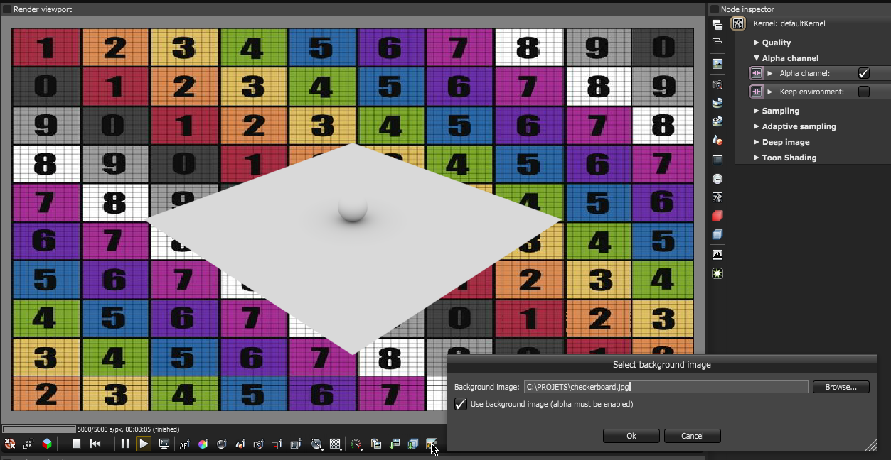

So as you found and as described in release log, to render Image plane,
in the Kernel node "alpha channel " must be enabled and "keep environment" must be disabled.
I guess this use the same feature as the "background" tool of Octane SA (but much more advanced in Maya: per camera, support sequence, respect image plane placement settings)
But as this feature is a post-process trick, image plane can't be visible in reflexion/refraction, for this use the "visible environment" node with backplate/reflexion/refraction enabled.
And I confirm as you noticed this implementation still doesn't respect image plane visibility or display mode to none, :(
@Bikram this should be fixed...

Hi Zurakan,
Thank you so much for your time.
1. The image plane works as it is explained and no need to delete the image plane node.
2. Octane is true unbiased render so these options may not be possible.
We are currently looking into the deadline submission issue, hopefully, will get it fixed in the next release.

BK wrote: Is it okay to post on our Feature Request page? [ https://render.otoy.com/requests/ ].
There's a misunderstanding here, I think the new image plane implementation is fine (only needs a way to enable/disable render), so not asking for other features because :
- In case someone wants to have the same behavior as in previous plugin, he can just use a real polygon plane parented to the camera ! :D
- If someone needs a background affected by DOF and only visible by camera and/or in reflection and/or in refraction, he must use the "visible environment" feature, which is now well integrated in Maya.
