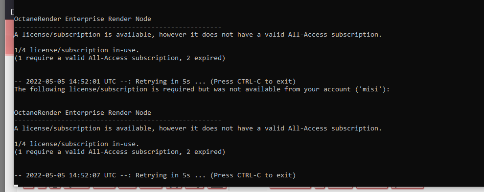

Hi All,
Jumping in.
I have one Enterprise license and one studio license.
On the primary machine, I run the Enterprise and I can see the other machine in the c4d Network rendering pop up window.
However, on the slave/node machine, I installed and run the Network render node but it gives me the error message that you can see on the attached screenshot.
Does that mean I need to have another Enterprise full license on every render node machine?
						Jumping in.
Octane Network rendering is different from C4D Team Render.
It is designed for adding the GPUs of the machines in your LAN to the Workstation via Ethernet in both Live View, and Picture Viewer/Render Queue final render, with animated and static scenes. So you can use its power in every phase of the scene preparation, speeding up a lot the workflow.
For Net render with commercial or subscription Enterprise licenses, you need to purchase extra Render-Node annual licenses for 99€, or pay monthly for 9.99€ per Render-Node machine:
https://home.otoy.com/render/octane-ren ... ender_node
You also need an Enterprise license for Master/Workstation, Studio licenses don't have Network Rendering support.
