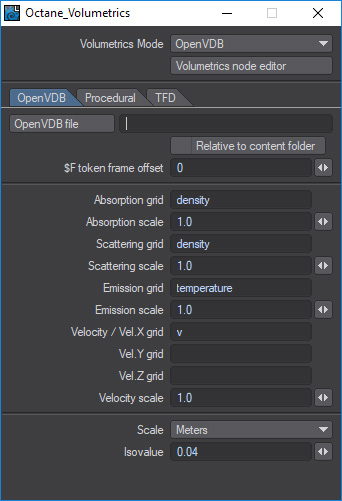

Sorry. The grid resolution is the resolution of the OpenVDB file. It is like the resolution in an image file. The only way to avoid the pixelation due to the lack of resolution is to export the files after computing the volume data with more detail. Usually, all the simulation software that export this kind of files have settings to control the simulation detail and the final volume resolution that is written to the OpenVDB files.
From the plugin side, we can't add more detail to an OpenVDB file that doesn't have enough resolution. Perhaps a tool to resample the volume to a higher resolution adding random noise or something like that could be possible, but well, the plugin doesn't have this feature.
Thanks,
-Juanjo
