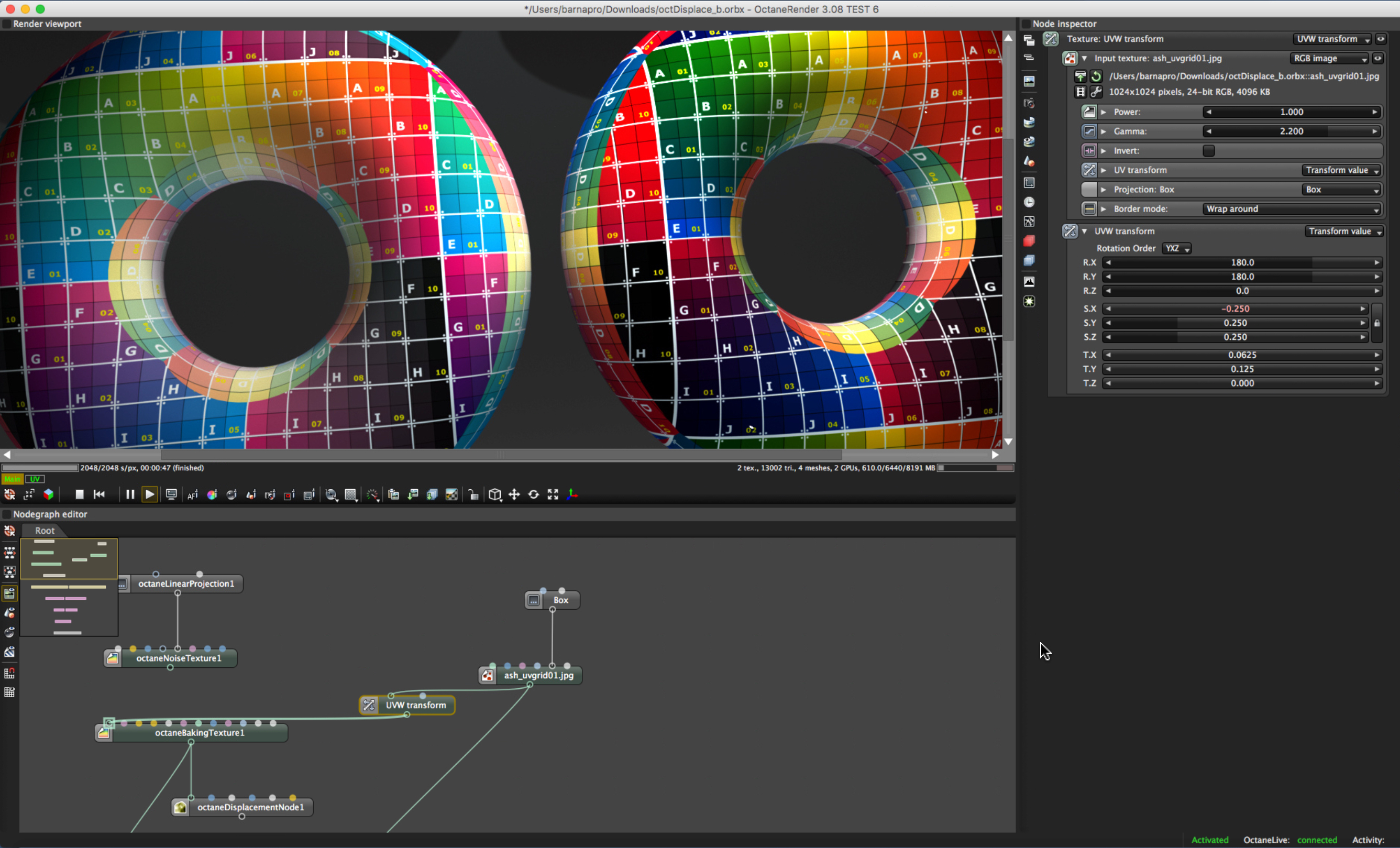

please, look at the attached images, when you apply a baked texture in a different projection mode, the dimensions of the object become important, so you need to apply a transformation:

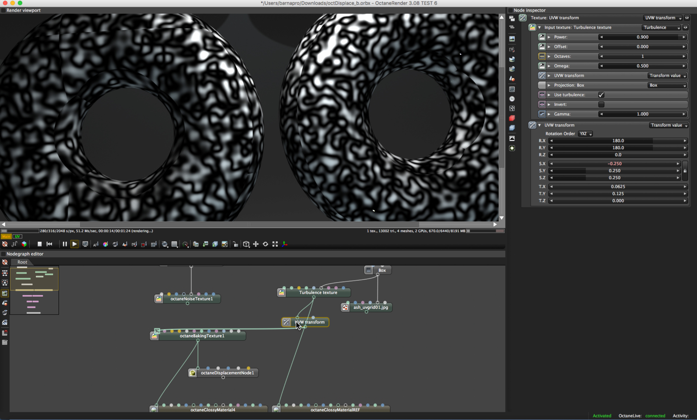

Replacing the texture with turbulance, you have the same effect:

Hey Bepe, thanks for taking the time,
- It seems in your example you also use a box projection in the bakingTexture Node and with the turbulence texture we can see that even like this the turbulence have been baked by the bakingTexture node like if the input was using a UVprojection,
because in the result you can see all kind of new texture seams inside the cube projection seams.
- Also in our case the bakingTexture node should always use a UVprojection because anyway the displacement node will always ignore any projection and always use the texture like if a UVprojection was used.
But thanks, anyway now i'm pretty sure the BakingTexture node just doesn't work,
to check on this just use any procedural texture with whatever projection you want (except UVprojection) and plug this in a bakingTexture node using a UVprojection,
then compare the procedural texture output with the bakingTexture output, you 'll see the bakingTexture node is trying to do something but just not what it is supposed to for a baking process ...
