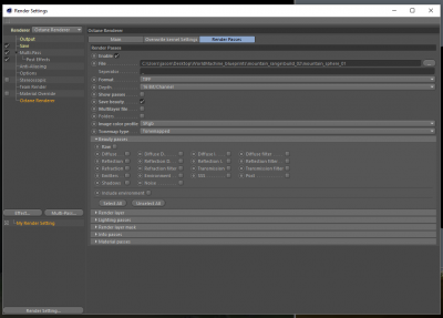

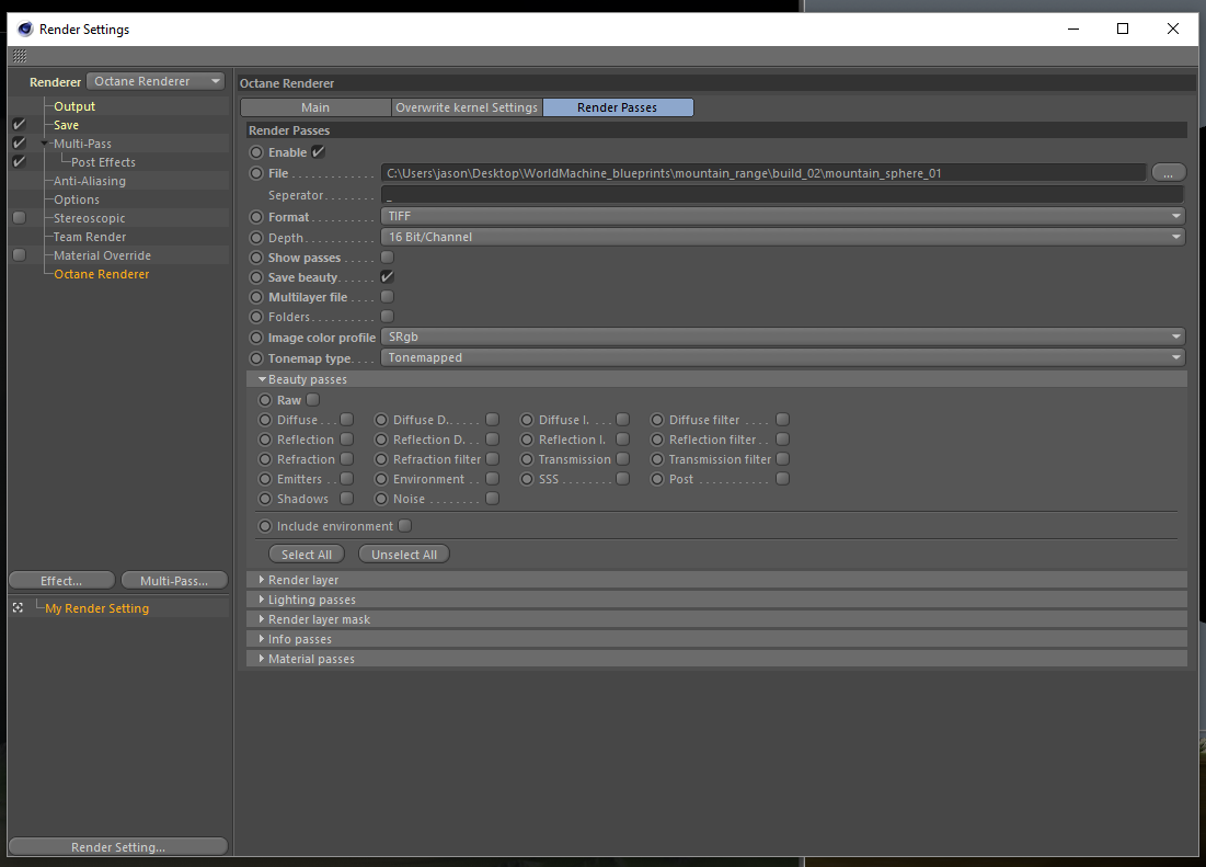

Here is the render settings and path:
Posts: 16068
Location: Türkiye
caldreemn wrote:Here is the render settings and path:
Did you checked any passes? As i pointed that it's working on me and completely strange if no for you. Did you tried to save to another location else of desktop folder?
Posts: 10611
it seems that the issue happens only if the file type is set to Tiff, with PNG, EXR, and PSD the render passes are saved correctly.

Thank you bepeg4d for figuring this out. I should have tried other formats, but I default to using TIFF files, so I didn't think of trying other formats.
