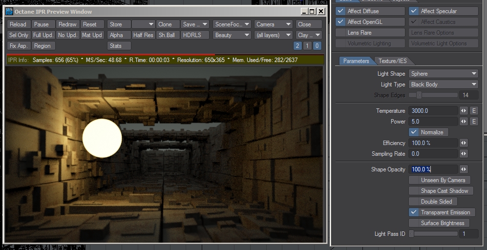

Hey Juanjo, Sphere light type seems to be behaving strangely.. or perhaps not at all.. maybe something broken with it... I am trying to do an invisible (transparent) sphere light with 0% opacity and Transparent Emission on, and it ain't doin' nothin'... :? Works for others, including Box... In other words, switching back and forth between light types works brilliantly, on all of them, until you switch to Sphere...

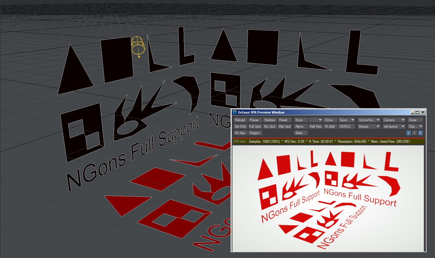

Juanjo, sorry, but ngons are behaving badly too. :? Please test and see if they are rendering correctly on your end.
Win10Pro || GA-X99-SOC-Champion || i7 5820k w/ H60 || 32GB DDR4 || 3x EVGA RTX 2070 Super Hybrid || EVGA Supernova G2 1300W || Tt Core X9 || LightWave Plug (v4 for old gigs) || Blender E-Cycles

FrankPooleFloating wrote:Juanjo, sorry, but ngons are behaving badly too. :? Please test and see if they are rendering correctly on your end.
Sorry, here my ngons unit test scenes seem to work fine. Can you send me a sample scene with this problem? It is true that some ngons have problems with the triangulation algorithm, but this issue is very rare.

FrankPooleFloating wrote:Hey Juanjo, Sphere light type seems to be behaving strangely.. or perhaps not at all.. maybe something broken with it... I am trying to do an invisible (transparent) sphere light with 0% opacity and Transparent Emission on, and it ain't doin' nothin'... :? Works for others, including Box... In other words, switching back and forth between light types works brilliantly, on all of them, until you switch to Sphere...
Thanks for reporting this issue. Yes, it seems that the light emission is not working with the sphere lights (that are using the Octane sphere primitive). Probably there is a bug in the Octane core. I'll check it.
The problem with the sphere lights is a known Octane limitation of the sphere primitives. The workaround is to set the Sampling Rate to 0.0, because now they are excluded from the direct lighting.
