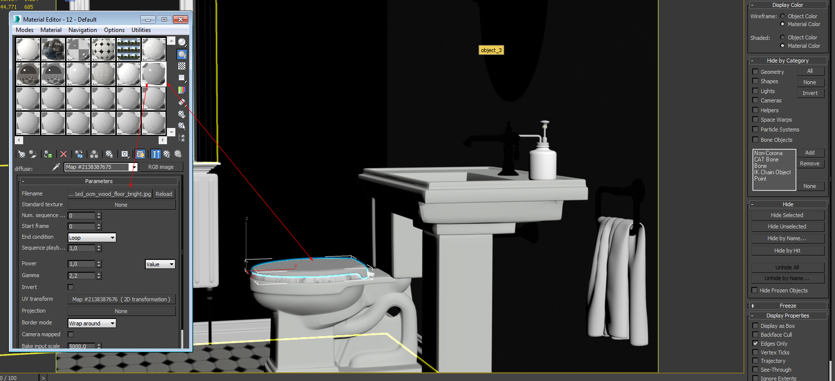

Hi Paride, yes I'm aware of all these settings AND I did try to downgrade to the previous installation and have no such issue with it, but it seems to operate this way on oldest files?
Furthermore now I have this issue were the Slot MAterial and the object applied do not show the texture not even on the render? Tried also to reset the material slot but nothing, BUT if I open a saved material from the local saved of mine it just behave normally.. I must downgrade

Hi justix,
this issue interests me, could you kindly share your file (even privately) that works with earlier versions of octane but not with 4.40?
I tried to recreate the issue with my files but I did not succeed.

Hi Justix,
about texture issue, I found that during the pre-release test and it seemed the developers fixed it.
I will check again now, because I had not found yet.
However, the workaround is to open the Octane viewport when choosing the texture.
I'm sorry, I was sure this issue resolved before release.

I checked the way you indicates me and the trick is really not convenient so I wait until is fixed AND I found several bugs relate to the material slot and I guess it has to do with the material converter or sort,
To get the texture visible AND onto the model I must drag the created one into an empty SLot
p.s. Why is the Material Slot Editor SO SLOW in refreshing compared to the well known ones? I'm on a i7 6850K 32Gb DD4 and 2X Gtx 1070.. it should FLY!
