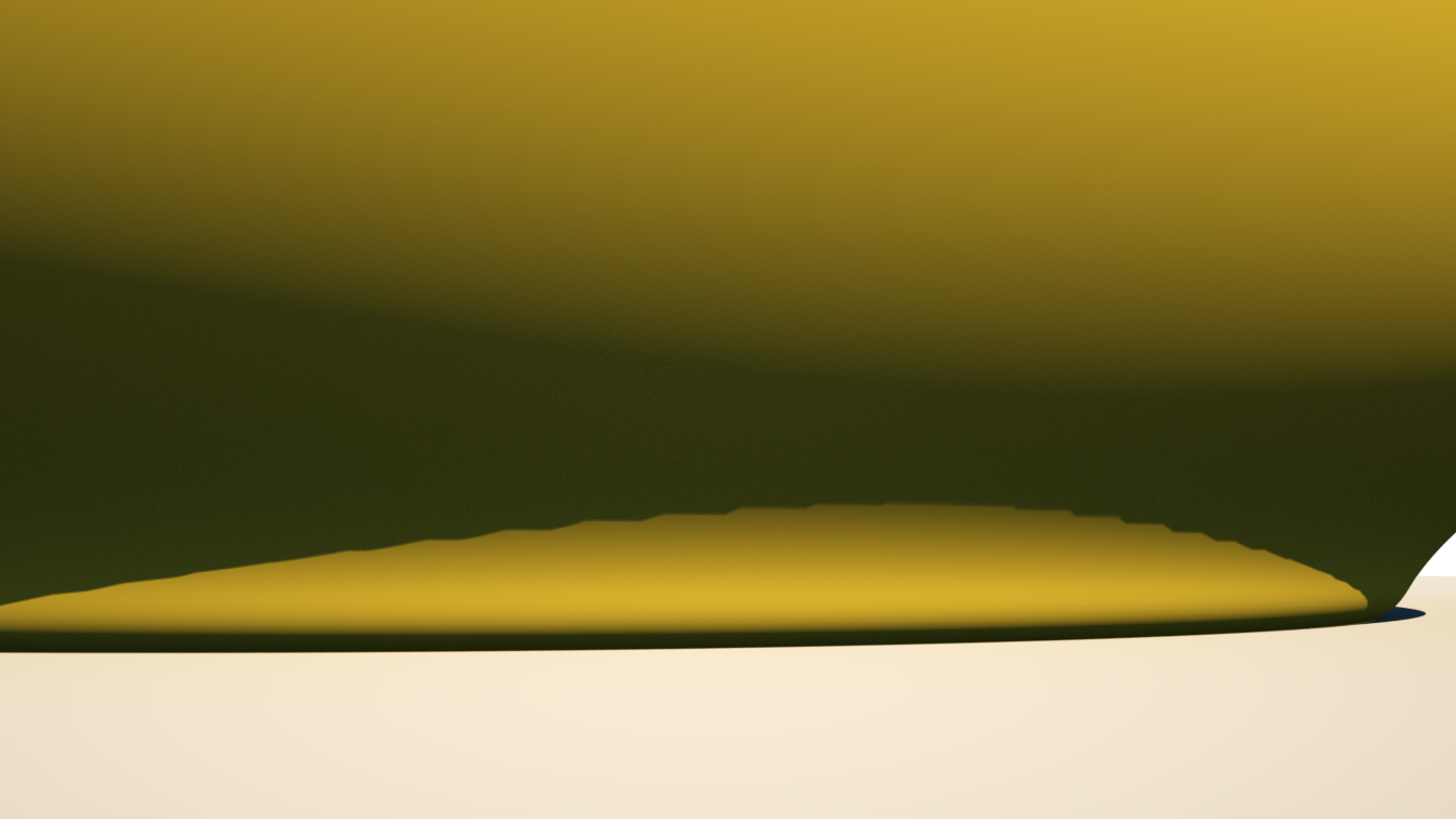

Hi J.C, I have checked the scene. The blocky polygons are visible only in interactive rendering mode, which is caused by blender optimization. In interactive mode, blender will not generate tessellation faces for faster renderinghttps://docs.blender.org/api/blender_py ... .tessfaces. Therefore, compared to scene render mode, there are much fewer triangles in inactive rendering mode.J.C wrote:Mesh smoothing is still as bad as it was in 11.xx
Checkout the attachements. Blocky polygons are visible.
With the attached file you may replicate the bug in earlier post - crashing when changing material.
For now, you can check it in scene render mode (more triangles and smoother faces).
In next release, we will add a checkbox to let you decide whether to generate tessellation faces in interactive rendering mode (default no for the consistency).
Hi DrawFun, rendering in final mode (F12) does not change anything.
This is with 100k triangles mesh: The same happens in Octane Standalone app too :/

Hi J.C, that is a ray-epsilon issue (too small ray epsilon causing geometry to self-intersect). You can try to adjust the "ray epsilon" value slightly in octane kernel tab to reduce them. More detailed answer from abstrax:J.C wrote:Hi DrawFun, rendering in final mode (F12) does not change anything.
viewtopic.php?f=9&t=48425&p=241445&hili ... on#p241445.
Besides, you can also try to Increase faces(via open subdivision) or light power.
Hi DrawFun, thank you for an answer but this is not a proper solution as it literary removes self shadow from the surface.

Due to the limited precision, it is a trade off in some cases. Increasing faces in some particular meshes or sub-meshes is another way to deal with it (the the teapot case, 400k faces seems goodJ.C wrote:Hi DrawFun, thank you for an answer but this is not a proper solution as it literary removes self shadow from the surface.
