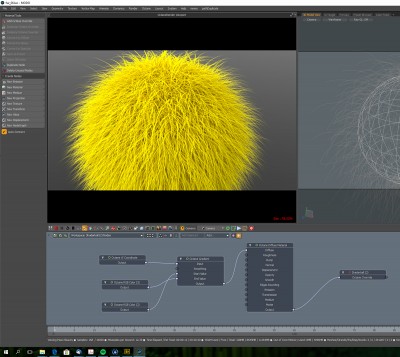

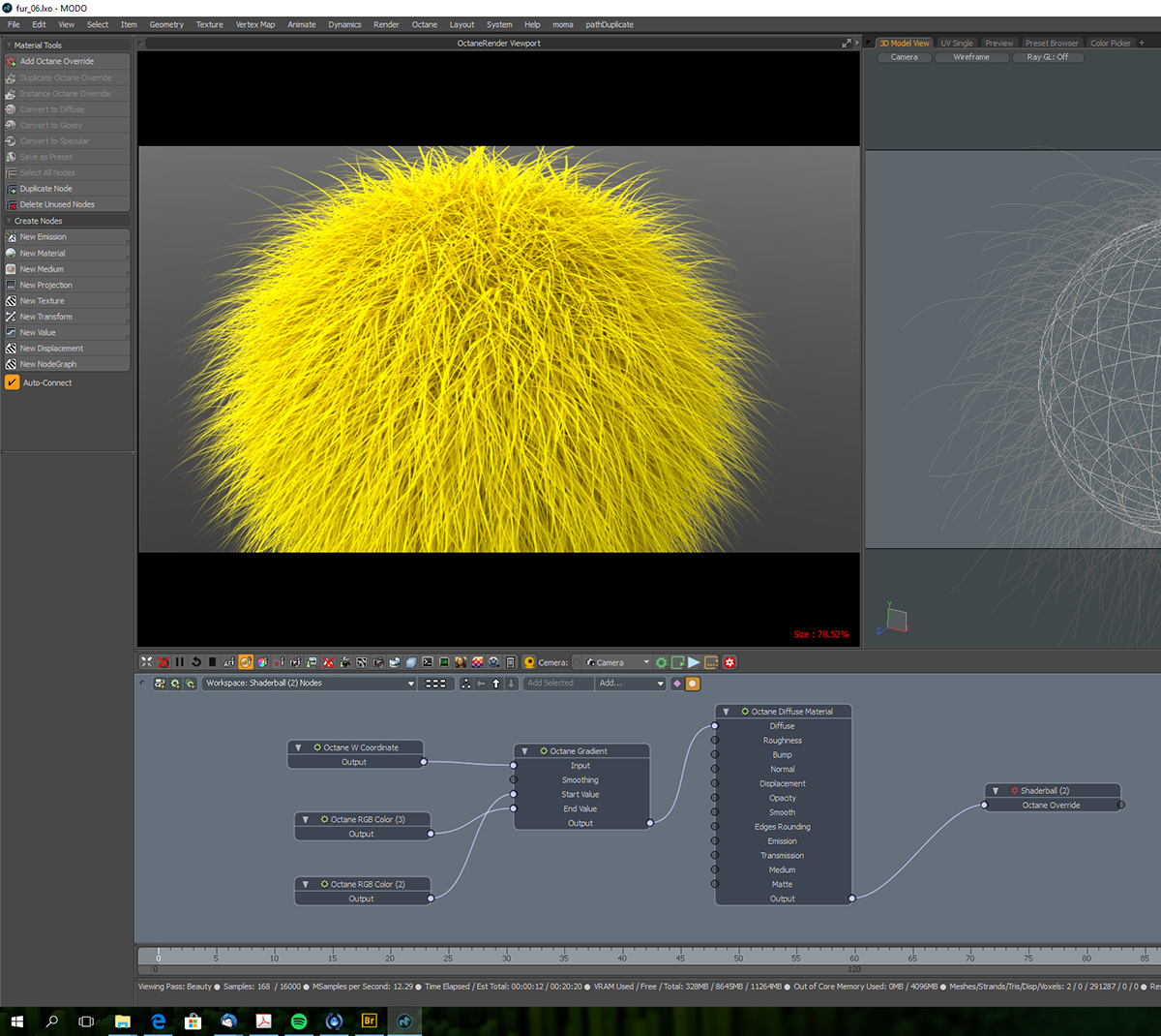

Hi Paul.
Here is my result of wcoordinate ... or I`m doing it wrong ?
My modo is 902 (108604) octane Standalone (3,07) Plugin verison (3_7_0_125).
Scen is here for download:
https://www.dropbox.com/s/xp522xba5mr39 ... m.zip?dl=0

Will you be able to add more modo fur features in future Octane versions? Like applying texture over individual strip of poligons using special modo projection "Implicit UV" ? Like in this file:
https://www.dropbox.com/s/r6vro770rtaqf ... s.zip?dl=0
I think this will be difficult to do unless you can get Modo to generate UV's for each individual feather strip. Using the render cache, the plugin picks up the UV's from the render cache, and no feather specific UV's are supplied when Implicit UV is used (Modo is instead providing the "Texture" UV map coordinates.
