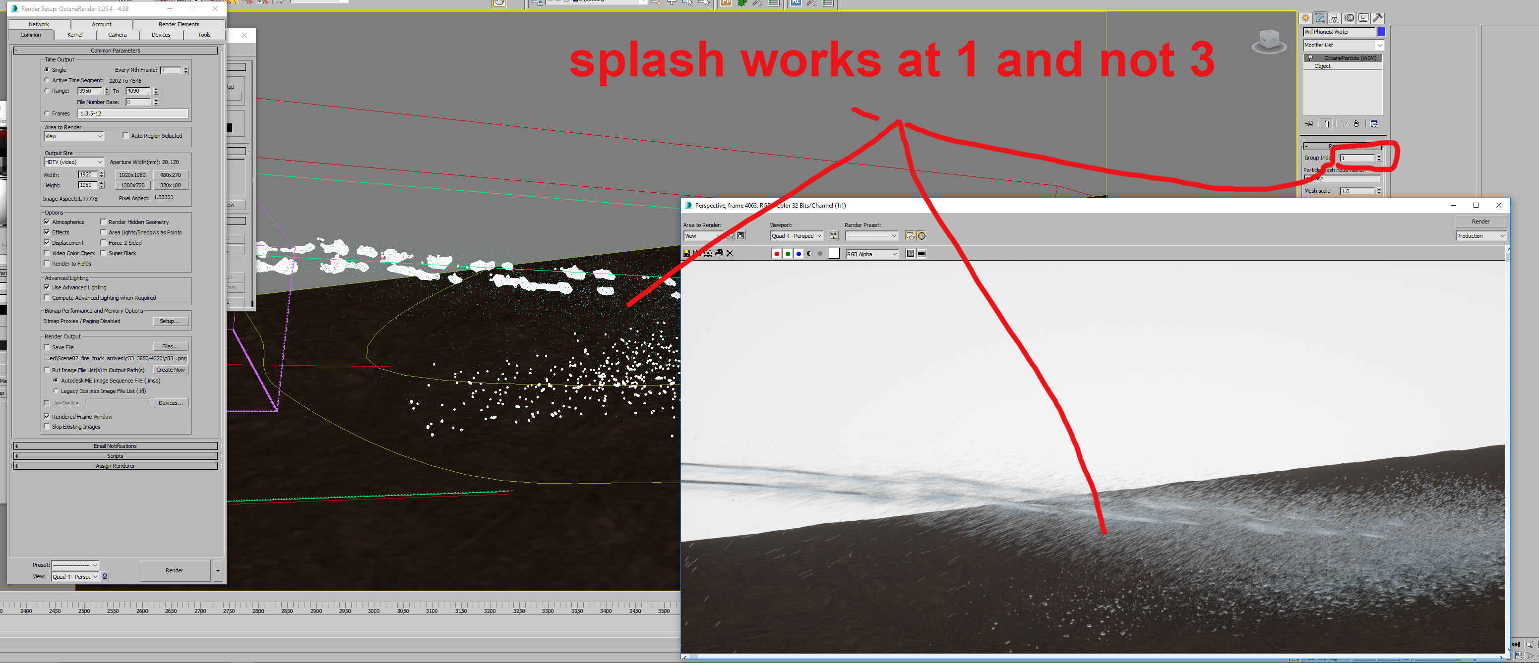

coilbook
Posts: 3099
paride4331 wrote:Hi coilbook,
I tryed index group, it should be:
1 foam, 2 mist, 3 splash
Regards
Paride
wow it is strange my splash works when it is set to 1 maybe because i have no foam and mist disabled and also have another fire sim with particles as sparks that are set to 0 index group
thank you
neonZorglub
Posts: 1059
Hi coilbook,
That's right, in fact, the correct group index to use depends on your particular simulation..
I added a note in the PhoenixFD thread:
Note about Group Index:
The value to use depends on the number of particle types that the simulator actually creates.
You can see this in the Cache File Content text box, in PhoenixFD Simulation tab, in the [PARTICLES] list.
If all types are used, the Group Indexes are: liquid:0, foam:1, splashes:2, mist:3, wetmap:4
When the number is 0, the type is not used.
For example, if foam and wetmap are not used / disabled, we get:
-Liquid: 1249 (Pos,Vel,ID..) <<< Group Index 0
-Foam: 0
-Splashes: 101 (Pos,Vel,..) <<< Group Index 1
-Mist: 87 (Pos,Size,ID) <<< Group Index 2
-Wetmap: 0
So, in this example, if you disable Splashes, you will have to change your Mist Group Index from 2 to 1 ...
: Always check this [PARTICLES] list if you have unexpected results..
Regards,
NeonZ
coilbook
Posts: 3099
neonZorglub wrote:Hi coilbook,
-Foam: 0
-Wetmap: 0
Regards,
NeonZ
Thank you
