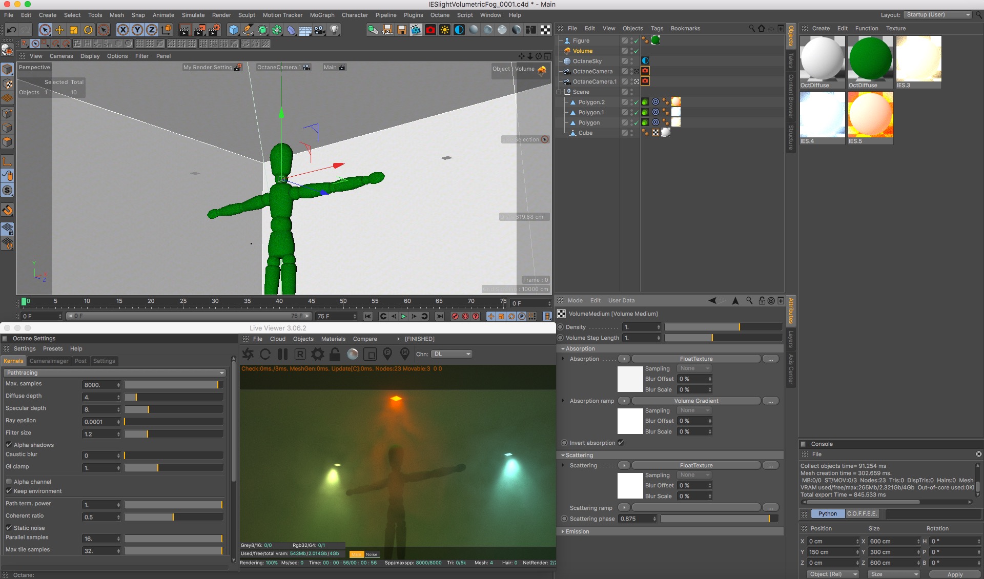

Sorry guys,
my fault, sometimes is better to personally test the things, the Gaussian spectrum node no longer works with Volumes. Now that we have the Volume Ramp gradient, is better to use this way to colorize the volumes, sorry again for confusion.
I have prepared a simple scene with three different IES emitter lights inside a foggy volume:
IESlightVolumetricFog_0001.zip
(110.79 KiB) Downloaded 183 times
