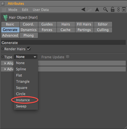

sorry face for the misunderstanding, we are talking of the same thing :)
anyway instances are perfect for grass and the hair module is already ready for instancing export.
