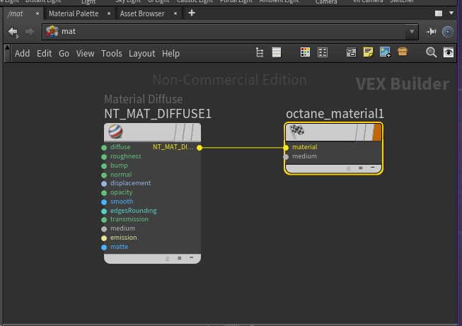

Could you please explain how the new H16 /mat VOP materials workflow works with Octane? I am unable to share nodes among different materials like with Mantra.
Thank you

WhyGee wrote:Hi,
I had added some information about this new feature to the docs, but unfortunately, some topics are now missing after the docs site update. I hope to recover all this information soon.
The Octane nodes inside the /mat context should work like in Mantra, but be aware that outside of the Octane Material Builder node, only the Octane "OUT Material" (the octane material output node) can be marked as material. All the other Octane VOP nodes can't be used directly as materials.
If you have any problem working in the /mat context, please let me know. It is a new feature, so it can have bugs or missing features.

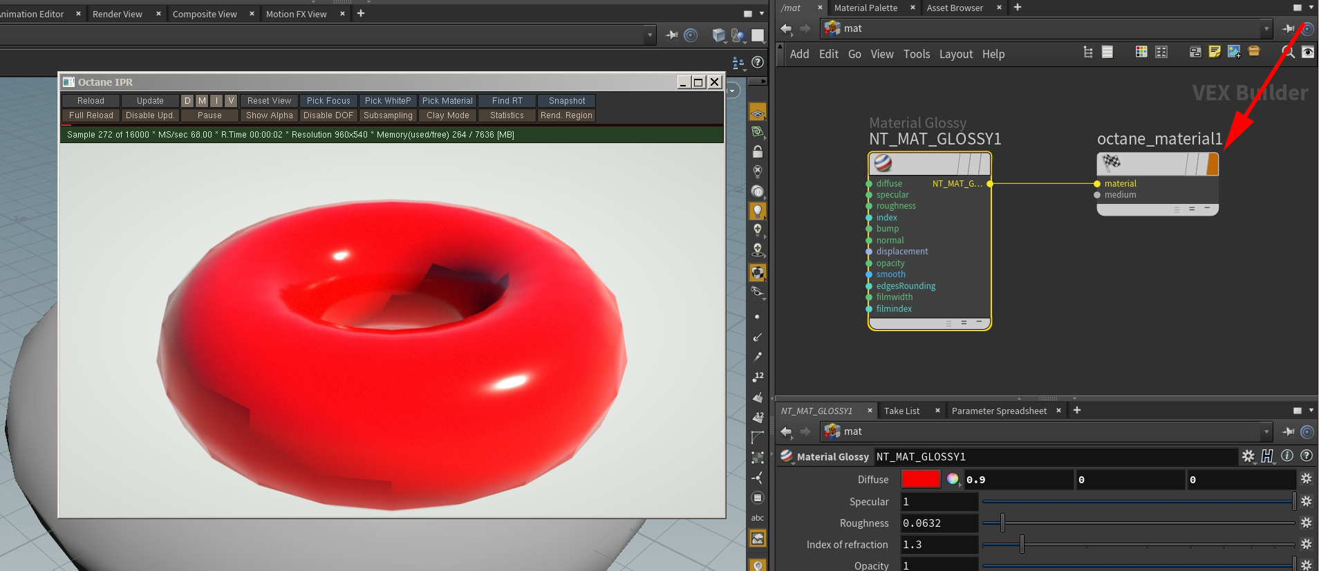

Yes that's what I've tried to do, but it seems to ignore assignment of the OUTMATERIAL directly.
Attached is a sample scene, perhaps I've done something wrong?
Yaniv

The problem is that you don't have the "Material" flag enabled in the OUT material node (the rightmost brown flag). I suppose that this flag should be enabled by default in this node, but I need to figure how to enable it from the plugin.

WhyGee
Posts: 189
Joined: Sun Jun 22, 2014 9:10 am
great thanks alot!
