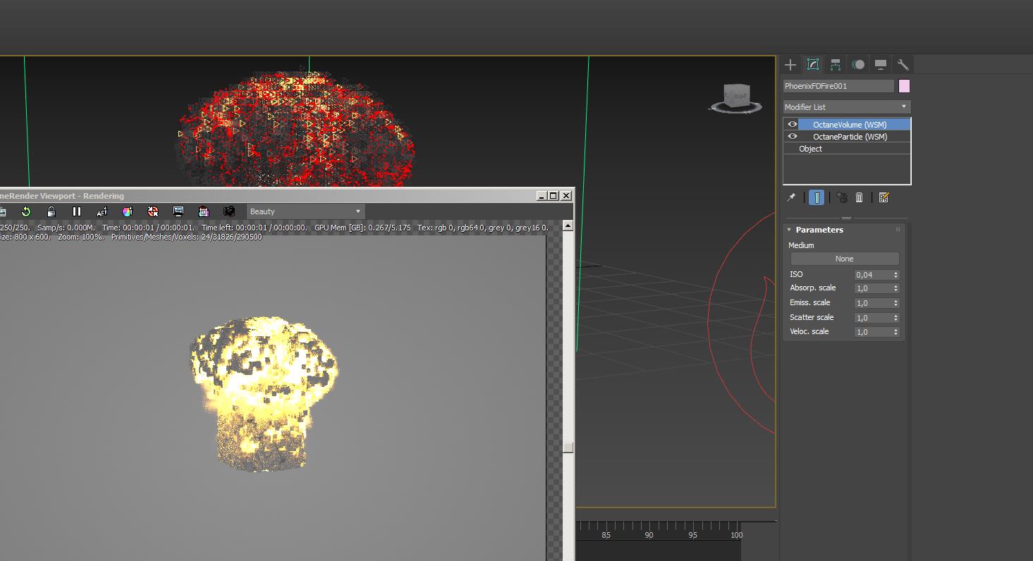

Looks Like this
low res sim and low res 100smpl Rander

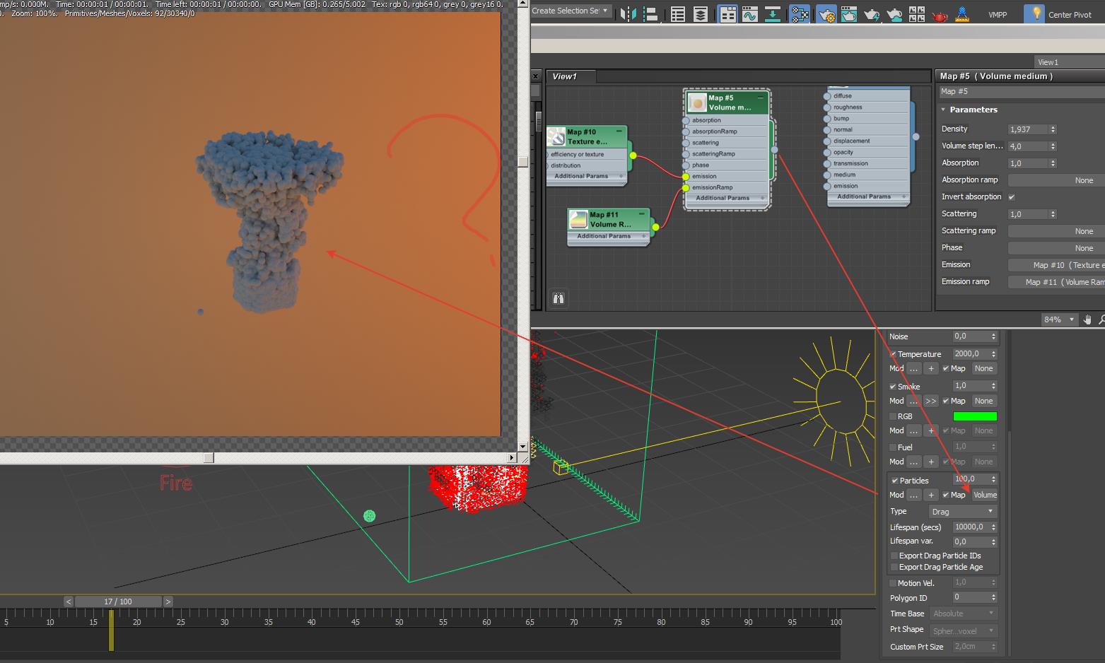

how to work with the Phoenix I know I am not to understand how to give the brightness of the particles

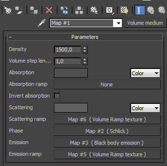

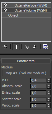

medium Volume where you want to append ?

Helpfull?

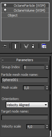

The "Mesh Scale" is animated from 0,3 - to 0

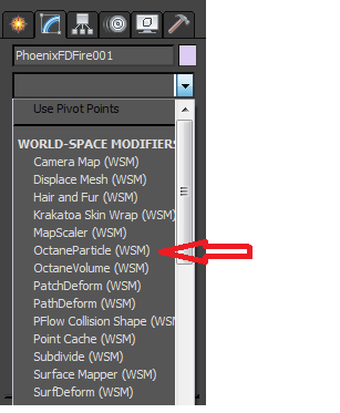

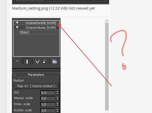

how to get it ?
ThaRaven
Posts: 114
Joined: Fri Feb 20, 2015 1:17 pm
In the Modefier Stack from the Phoenix Container

thank you
