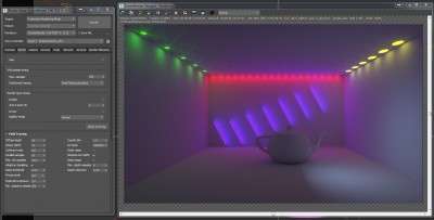

true mixing of light ?
I have no idea how to set a sophisticated scene with the light - I nenashel no single solution as quickly optimize complex light - the only solution is to scatter the light as it is at the ID and then do precomps and count 10-15 thousand samples - but then the crown of the render is faster and more convenient in the interior - what you say - because she has 1. the absence of changes in light 2. light mix I'm totally confused and don't understand how to properly configure complex light in octane render - 5 interior project I'm doing with post corona render because it turns out much faster
from your words I understand that octane is not able to quickly deal with a lot of light and the more groups of light the slower the rendering the more noise in the picture and the more you need passes ... + I can't separately control each light source because the light illumination of the individual scenes one of a source when you hide the group, he is incorrect in brightness

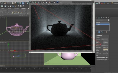

thank you paride4331 !!! but it slowly 12000 samples will be === for example, the corona render would be faster to count than my two video cards 780 - I above wrote to you that the only way to count the interior

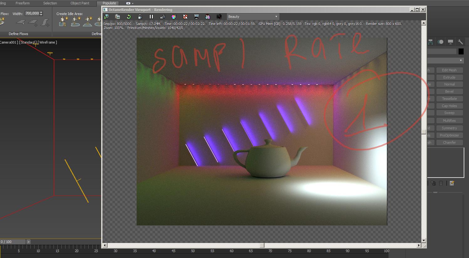

with regard to sample rate
sample rate is pretty hard to tune .. especially when a lot of different light example here
sample rate optimization
sample rate no optimization = 1
try to set a scene and you will understand how incredibly difficult it is
I'm trying to set one group of the light on the left, leans to the right group - I'm trying to set the brightness of the red light sources changes its value the light the light in the room ... it is this process that I do not understand because it defies logical explanation, at least for me

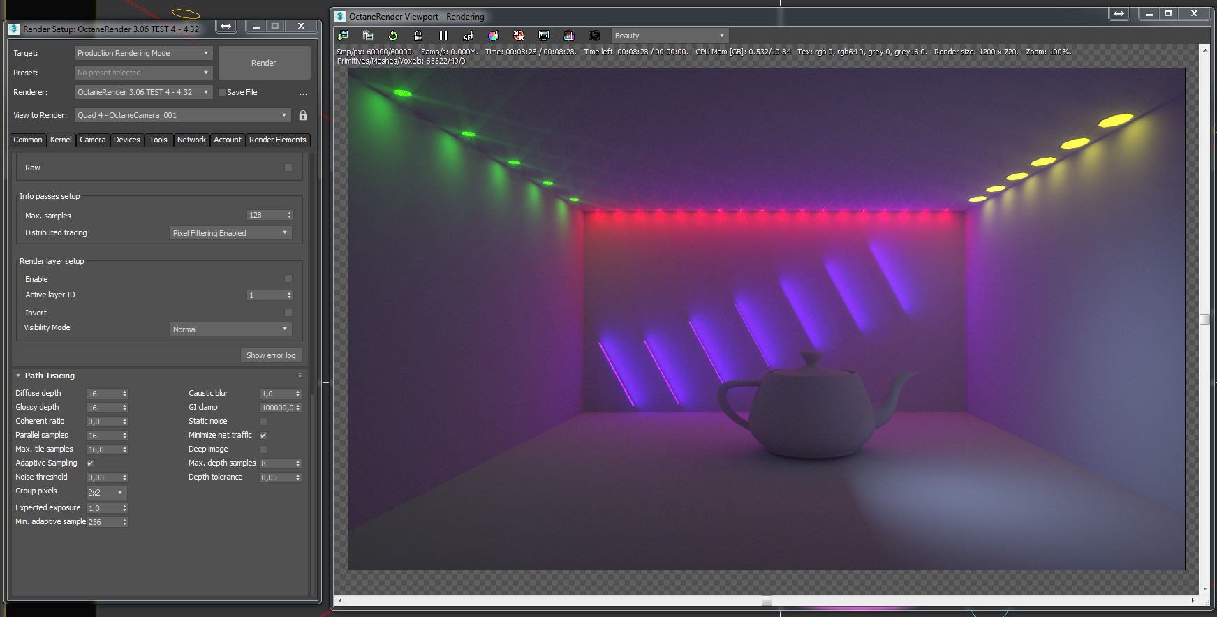

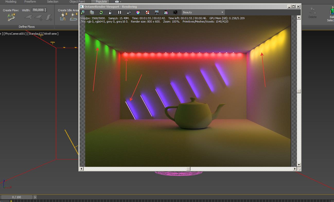

Hi goldisart,
a render Lynch style setup..
maybe the issue is getting comfortable with software that does not use color mapping to adjust the render.
Try to take a look at the scene, there is some small trick to speed up the render.
Many spotlights, 1200x 8 minutes 100% noise free, I think it's a great result with 10 min setup workflow.
Regards
Paride

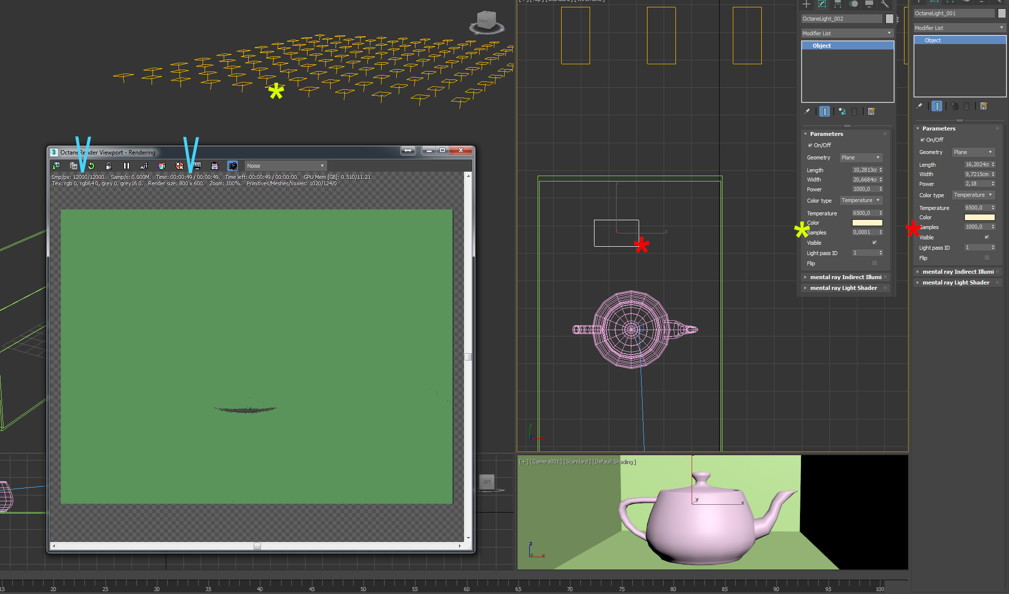

HI Goldisart,
Increase "Light sample" not Max. sample.
said this, Octane is a GPUs render engine; to work needs GPUs.
Gtx780s were released in 2013, I do not think with an i7 Haswell you can go very fast today with a CPU render engine.
I would consider buying at least 2 gtx1070 to renew your workstation.
Regards
Paride
