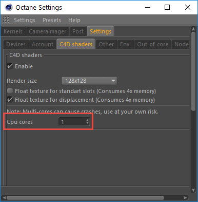

And what's your parameters in c4d_shaders and others sections?

- a1.jpg (40.81 KiB) Viewed 3470 times
