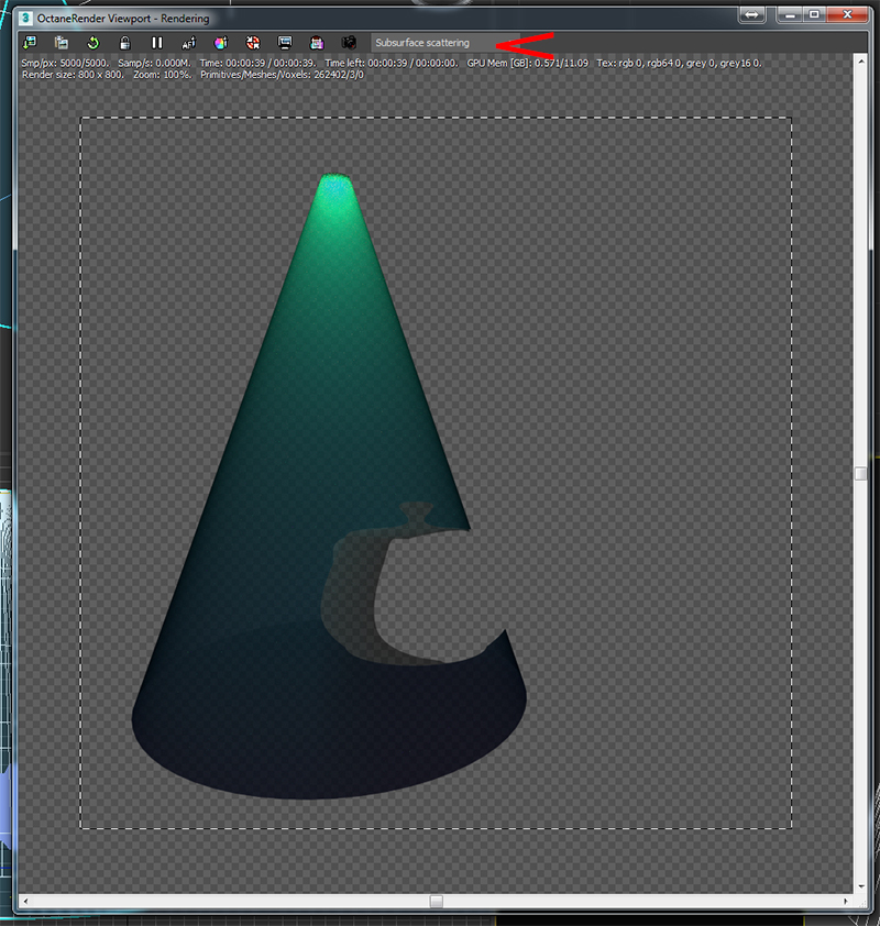

Hi thekwen,
about fog with alpha you should use the subsurface layer scatering.
To work with falloff, you should create a mixmaterial adding a material such as fog, without medium and adding falloff map in opacitiy.

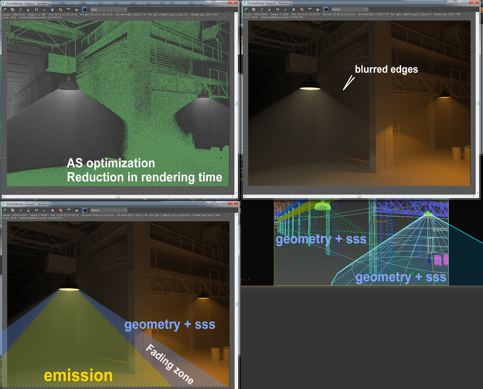

managed to do something like this with the above file - added faloff on the opacity channel on top of all of this.. that dispersion around the edges is the key - I tried getting the same result through the scatter node, but didn't appear to be achievable.. - it's slower with the alpha channel on
..basically it is a huge pain in the ass to do anything with volumetrics, it seems something is achievable through this cone/sss technique - only it will go through the geometry (maybe if the volume detects and automatically booleans the cone with any geometry it touches.. can be achieved - or - some workaround the octane team could do inside the 3dmax plugin).. like at least it can behave like a post effect, or create some fake volumetric light.. or bring us example scenes with usable setups to analize from..

You're right but with Adaptive sample and expected exposure, sss calculation is helped, time is very optimized.
About blurred edges, a system might have a bit geometry larger than your beam of light.
