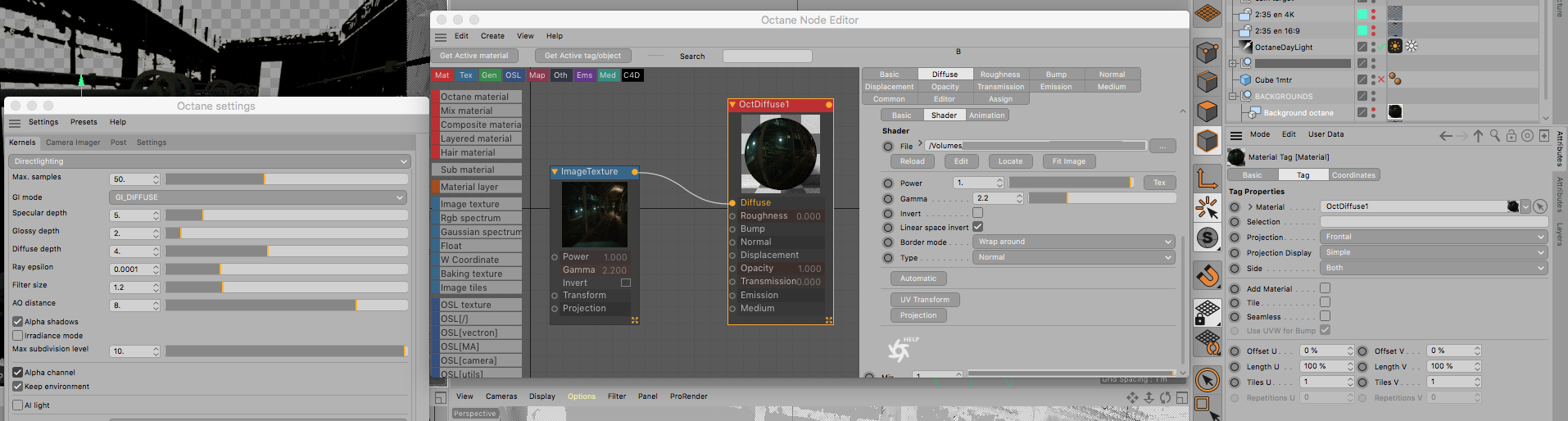

1) Render Settings - alpha channel
2) In Octane Settings - Kernel tab - Alpha Channel (Keep environment for HDR visible)
3) For background object Cinema 4d apply octane material - diffuse. (not c4d material, it doesn't work). In diffuse add your texture
4) For shadow catching apply diffuse material. In Diffuse material check in Common - Matte.

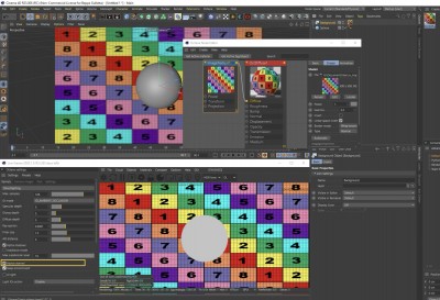

So here is a new riddle I did all thigs - pathtracing,enable alpha, disable environment, I have been using octane mat and c4d material and pbr material, and video in texture and still image in texture, and camera imager whatever that means but my background is not visible unfortunetly. Can someone knows what is going on in my relationship with octane?
Posts: 10606

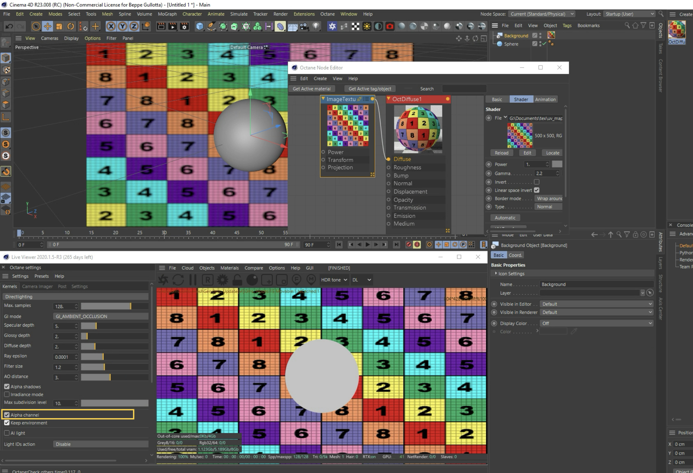

Hi dekar07,
please thy these steps:
- enable the alpha Channel option in Kernel setting,
- create a c4d Background object,
- apply an Octane Diffuse material to it,
- create an Imagetexture node in Diffuse pin with the desired image file inside:
ciao Beppe

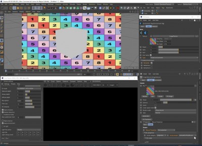

Hi Beppe.
I have been going nuts over this for a long time.
I have followed your steps and it was still not working. Couldn´t believe it, so:
As I always render to viewport, I tried to render to Live Viewer window and indeed it DOES render the background there, but NOT in the viewport.
Also the background object with the octane diffuse material is not showed in the active camera viewport when octane render is paused or not started.
So I need to have
1- backround object with a standard c4D material YES visible on editor/NOT visible to render
and
2-backround object with a octane diffuse material NOT visible on editor/ YES visible to render
C4D R21.207
OctaneStudio-for-C4D-2020.1.5_R4_Macosx
nVidia GTX 1080
Any help will be very wellcomed.

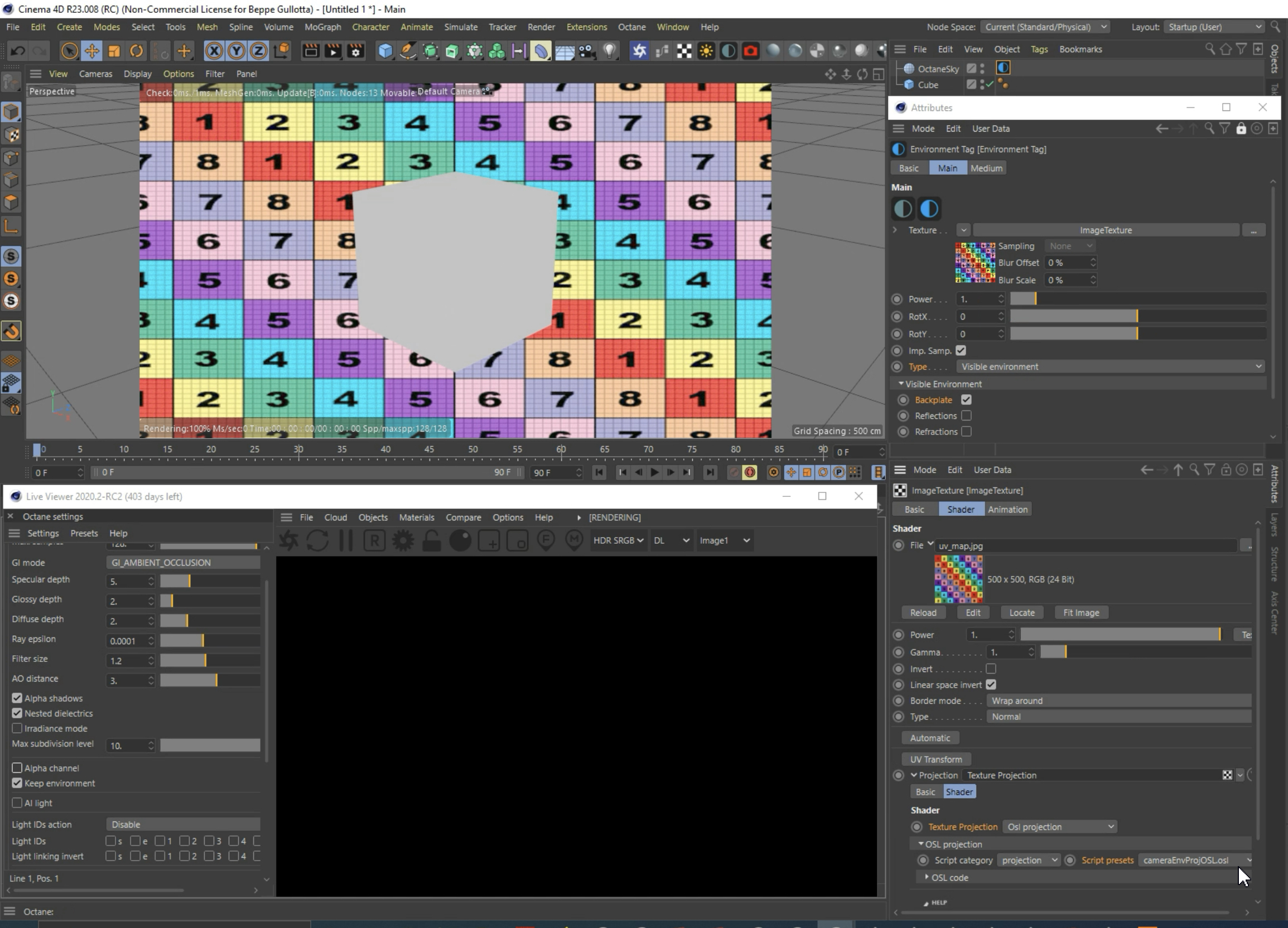

Posts: 10606
instead of the c4d Background object, you can use an Octane Environment Object, in Visible Environment mode, with Backplate active.
Then change the Projection to OSL Projection, and choose the cameraEnvPrjOSL preset:
ciao Beppe
iRota
Posts: 45
Joined: Fri Mar 01, 2019 10:02 am
Hi Beppe, thanks, that works in the viewport render.
How should I adjust the OSL projection (size) to match the camera, it's a vfx background plate I need as background reference. The texture is tiled now and not accounting for the camera aspect ratio.
