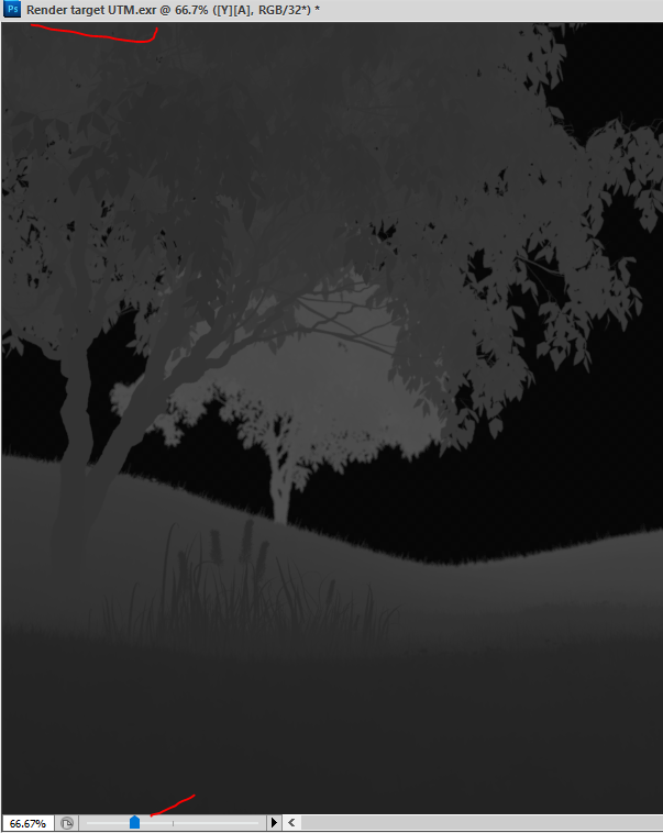

vijay_thirukonda wrote:justix wrote:Noticed the interface of the AS has now changed into only 2 Values BUT with AS ON I now have this kind of artifacts that I never had before .. Min Adaptive Samples 128 Noise Treshold 0.020
Increase the Min adaptive sample value to either 256 or 512.
Hey Vijey,
Indeed I also noticed this artifacts in previous version with group pixel 2x2 or 4x4 , even with high minimum sample,
depending on the scene we can actually see the 2x2 square or the 4x4 square,
So then I used the "none" option, but I had hard time to understand how the noise detection was done in this mode.
So then I thouhgt maybe that was the point of the adaptive strengh attibute, mixing back a little of noise to make the squares disapear,
But anyway both of these options are gone now so I'm confused ...
(also didn't have time yet to test seriously adaptive testV2 version)
