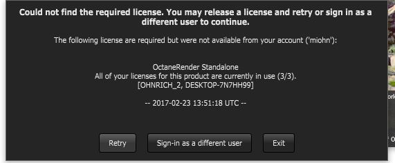

ok, try to do simple steps:
* turn off Your machines, go to OTOY account & make sure all licences are released.
* turn on Your main machine fire up Cinema or so & check OTOY account to make sure one licence now is in use..
* turn on second machine with daemon installed, see if Your master can see render node look in OTOY account to figure out what licence it use.
* turn on third machine..
from what You're telling now.. it seems that You're trying to release licence on what machine, but other one is released
it's hard to say if it's users mistake or something messed up with licencing.
try to go step by step.. not with all machines running, especially if You do not know which one You're deactivating & let's try to figure out where the problem is, because from information You're giving..it's hard to help You.
glimpse
Posts: 3740
miohn wrote:super!
this is on Slave 1
"it sais, that all 3 licenses (3,3) are in use , but only 2 are listed"
What the hell ....
regards
MIke
Strange issue, just forwarded that to OTOY's person responsible for Licences.

Hi Tom,
I did it exactely this way "step by step"
The strange thing is, that I cannot get the license for only "one" Slave running
Second PC is still powered off.
Hope to hear soon from Otoy.
regards
Mike

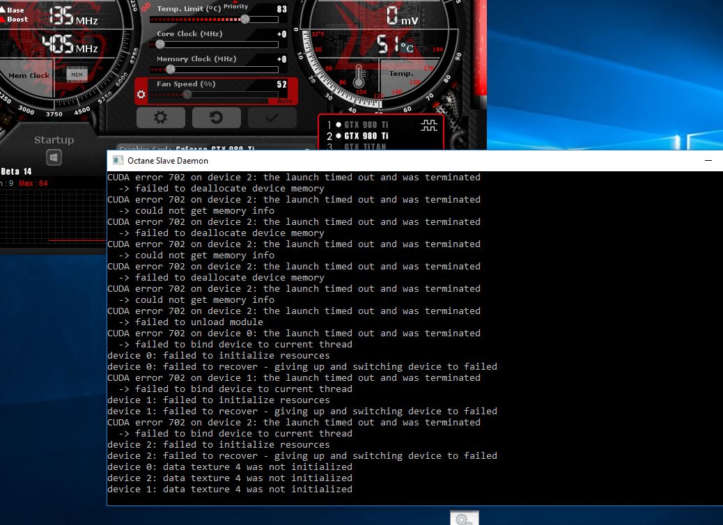

by the way how is with that cuda 719 error? still seeing that?

Cuda errors still there.
First I recognized, that I had too much polys, but now (after I corrected the scene) with
VRam usage of 470MB and 500.000 Polys (which should not cause any problems)
the Slave still giving me that errors a few seconds after starting (the new PC)
So now I have not even one slave anymore. :(
lost atm
regards
Mike
Posts: 10598
Hi Mike,
about activation, really weird, I'm sorry.
I'm guessing, did you enable the off-line mode in the past for one of your machines?
ciao beppe
miohn
Posts: 777
Joined: Sun Jun 06, 2010 3:00 pm
yes, on the new PC when I first installed the slave I
selected "offline".
Does this destroy the whole licensing process?
regards
Mike
Posts: 10598
Hi Mike,
yes, probably this is way your licenses are not floating.
Please use the Standalone to remove the off-line mode and sign-out.
ciao beppe
miohn
Posts: 777
Hi Tom,
o.k. signed out and started new slave without "offline"
I checked standalone: it sais "online" now.
But on the other PC still same probleme.
Nor slave nor standalone can be started.
My Cuda-errors: which driverversion do you recommend to try?
I have 2x 980 ti and 1 x titan (old version)
regards
