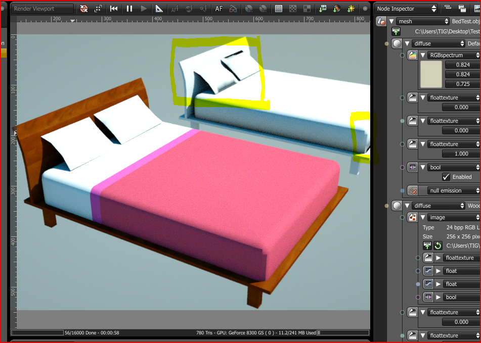

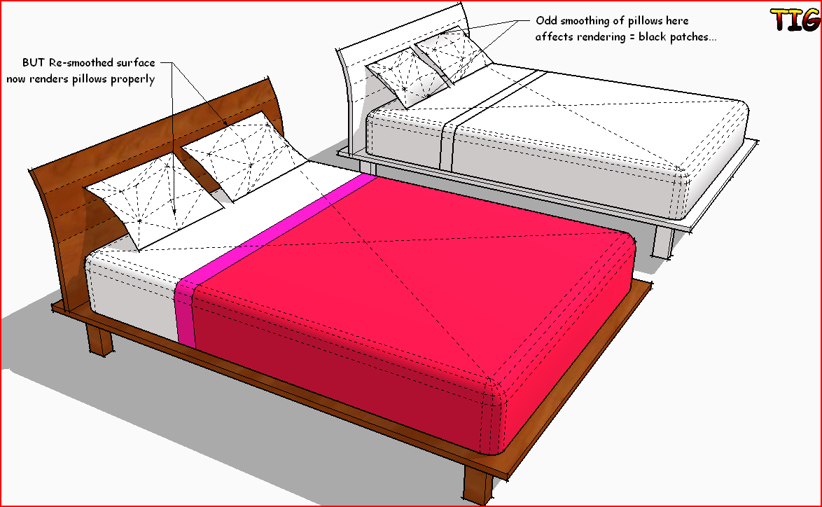

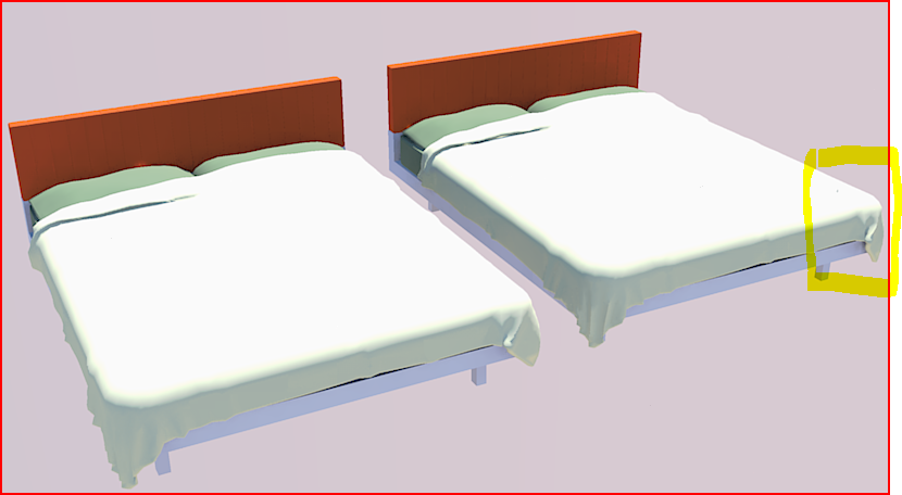

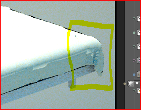

***PS: After some messing on I have also managed to reproduce something like this - and get black-patch artifacts on a 'smoothed' pillow in an imported 3rd party bed SKP. It's NOT reversed faces as these would show 'buff'...
There was also a similar small artifact on the bottom end of the bed-cover...
However, I found that a simple re-smoothing of that pillow component etc removed these artifacts when it was re-rendered, so all was OK.
I have made a compilation of the two - an original 'faulty' and a 're-smoothed' version: there are SKP and OCS screen-shots of them below...
So, my recommendations are try re-smoothing any problem group/component with coplanar-smoothing and smoothed at ~70deg...
The Monochrome tip given above is still useful... BUT I suspect that 'over-smoothing' is perhaps at the heart of the issue...

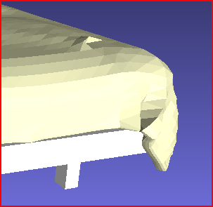

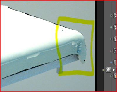

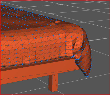

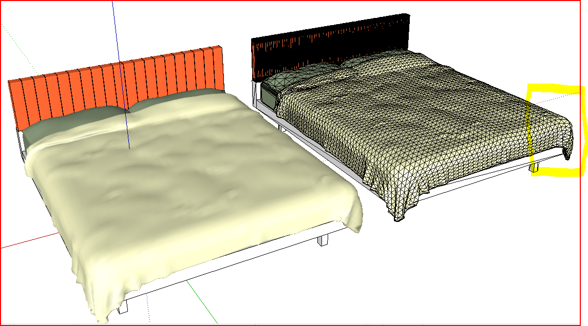

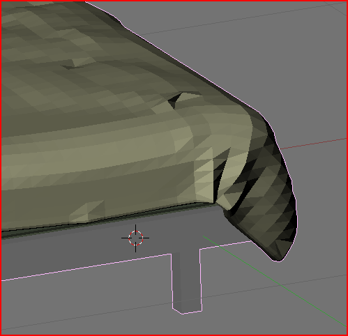

The screen-shot show your model SKP with the exported OBJ file re-imported next to it [un-smoothed for clarity].
You can see that apart from the triangulation [required by Octane] the form and all of the facets are matching.
However, when I view/render the OBJ in the OCS I find that the smoothed surfaces appear messed up - so this perhaps seems to be an Octane issue?? There's also that weird black 'halo' affect ???
Because IF I use the OBJ file in various other packages it appears correctly formed too :shock:
I've shown the same 'corner' in each 'type'...
