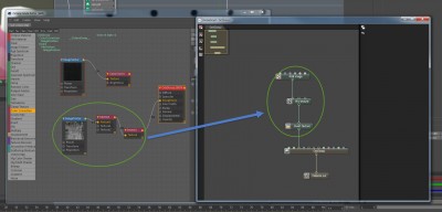

After lot of hours on spent this my conclusions it this:

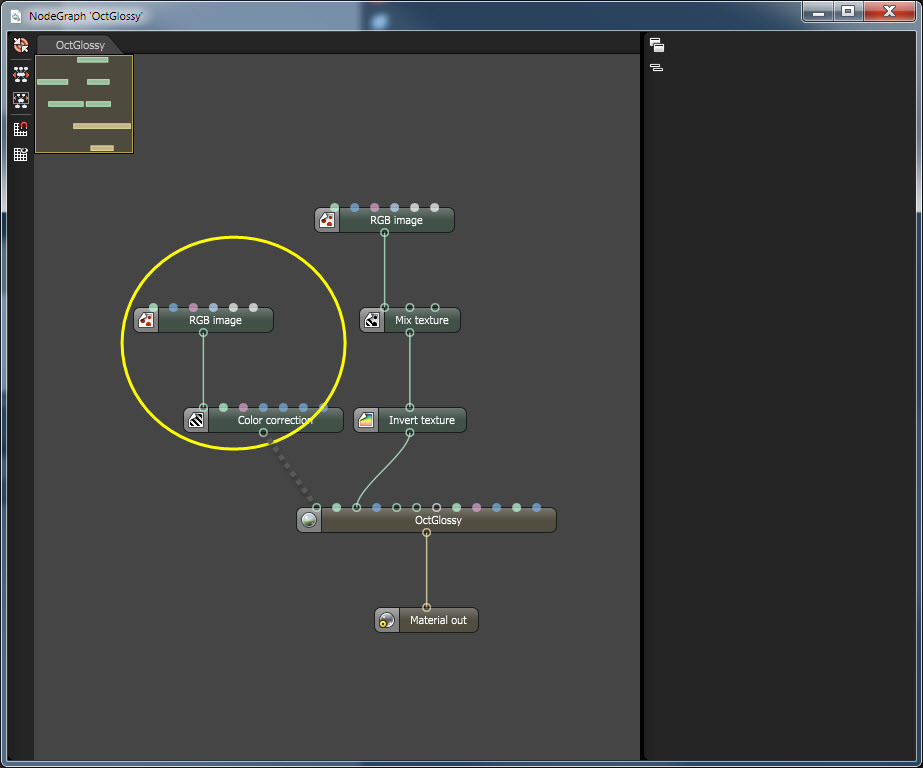

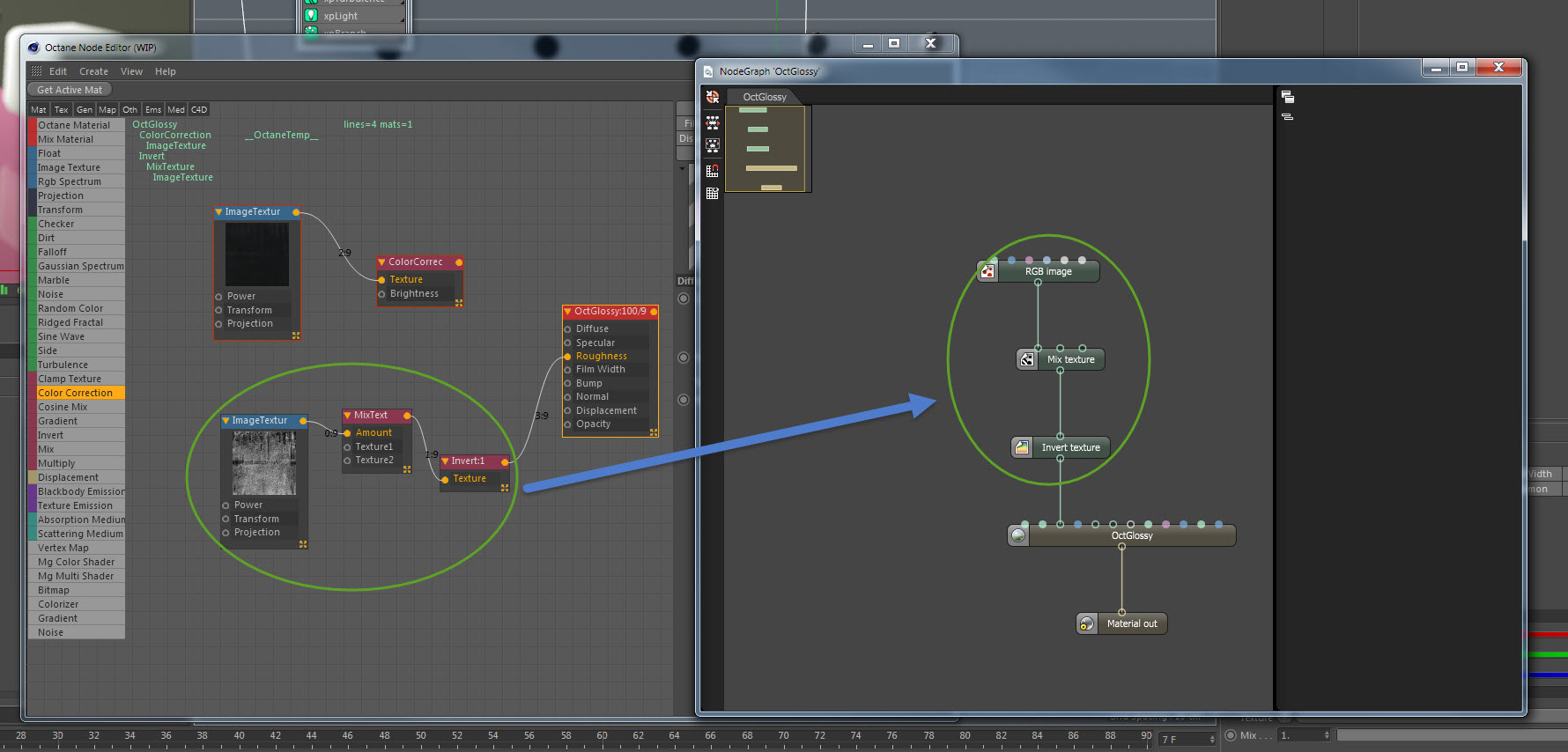

When you remove a texture connection from material it doesn't create this image to nodegraph. But when you reconnect it to material then recreates the image in nodegraph. See two images what i mean.
Solution is to keep unconnected image in nodegraph. So this avoids the reloading of the image by octane. Like in next image.
But this can cause some new problems to avoid. Like occupying vram with unused images. Could you get what i mean?
