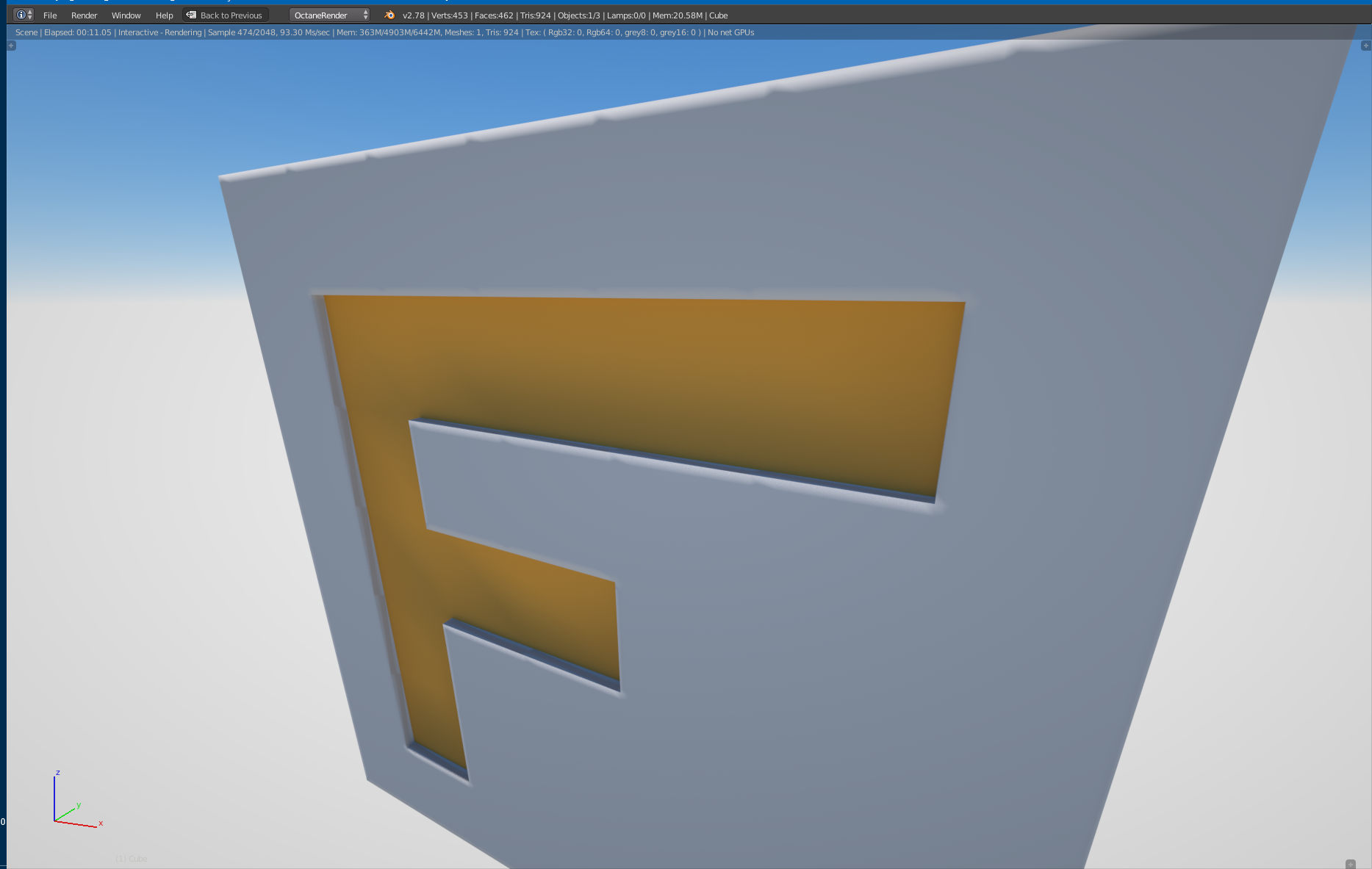

Inline vertexes that are common points for two internal edges are quite problematic for this algorithm.
roundtest.blend
Blender project file
(111.62 KiB) Downloaded 216 times
