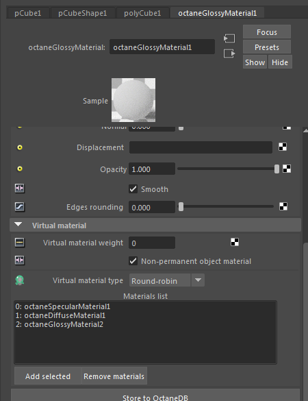

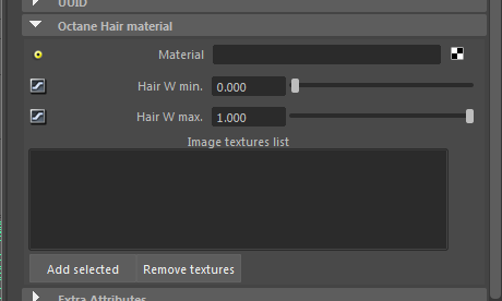

Jolbertoquini wrote:One other question "octaneRandomColorTexture" should work with hairs or maya instances? for me is working only with particles instances?
This is the "Virtual material" feature was made for in Maya plugin a long time ago. You have a lot more flexibility, changing everything you want to be pseudo-random (random inside a set of pre-defined materials), not just a color (e.g. roughness or even type of material).
To make use of Maya's native assigned hair colors - you need to properly set up the Octane material in hair's transform. Because the only way for Octane to make use of Maya's colors is to bake them "on the fly" into the texture - you need to set up a material with Octane image textures connected to desired plugs (e.g. to "Diffuse"), and you need to add the chosen material's image textures which you want to be baked on the fly by Maya's hair colors - to the "Image textures list" below the material field.
@JimStar
The randomColor node is very different of the virtual material,
with only one node you can create almost infinite variation in a material, or using it as the blend factor of a mix materials to create infinite materials.
The use-case for the virtual material is very very rare, so rare I never found a way to use it in production in five years.
And it's really not handy to use.
For example if you want 100 variations of shader you have to define 100 different materials by hand :shock:
Also the UI to link the virtual material is very buggy, the linking fail most of the time or doesn't refresh,
(better to link them in the node editor, it works flawlessly),
and the weigth attribute is broken or very mysterious.
One usage would be if I had a huge number of objects or instances, for example for Christmas tinsel lights or vegetation leaves,
for which I woud need to assign randomly a fix list of specific shaders.
But for this I would use a script to assign randomly the shaders and still have some control anyway.
Hi Jim,
Also virtual material doesn't work when we do batch render they are change shaders on each frame This is the reason i'm not using can we have a fix for that! I already told before.This happening because in each machine the result are different. so is flicker on the end result
